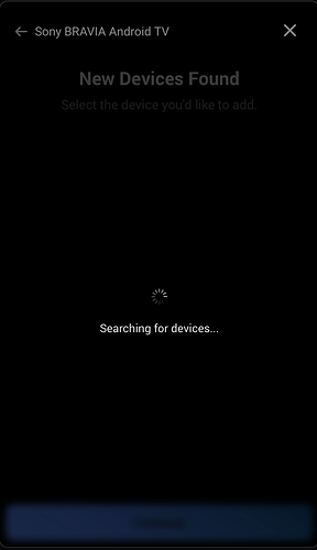

Hi!
If i search for devices, i get: network request failed. Does not matter if the tv’s are on or off. There was one time the app told me there were no devices found, and i can manually add them. But I clicked it away. Now i regret that. Is there a way to manually add the tv’s? Maybe my network is blocking the search action, but i can not find the setting.
It seems the Lan access is not possible. The app uses SSDP to discover the devices. If nothing is found, the vie for manual pairing is shown.
Perhaps the pairing is knterruptes if the SSDP trows an error.
I will try to switch to manual pair view in this case (next week). Im the meantime you could try to allow broadcasts or discovery in your router settings.
Tanks for the info, i have the app reinstalled and now i can got the manually install option again. But after i put in the preshared key the app searched and failed again with the same error. I would look into it, maybe i made a mistake.
I will also look why my network is blocking SSDP. I would be no surprised if my Deco’s are guilty of that…I’ll keep you updated :slight_smile:
If you proceed the manual pairing, the app tries to access the device API. That’s a standard http request.
What TV do you have?
Does it support the Sony REST API?
Preshared key is activated in TV settings?
I tried to proceed the manual pairing, but after i put in the key, the app searched and failed again with the same error. I dit not manage to get the manual pairing option again. Even after deleting the app and reinstall it. That’s what helped yesterday.
I have the SONY 4K KD-43XH8505 (2020) and the SONY 4K OLED KD-55A85 (2020)
I was testing with manual pairing with the 43 inch one. In the settings i can make a pre-shared key. I have no doubt that the 55 inch one has this option too, since that is the ‘better’ TV. But i will look in to it today.
I will also put the TV’s on network cable, i still suspect my deco’s are guilty of the network fails.

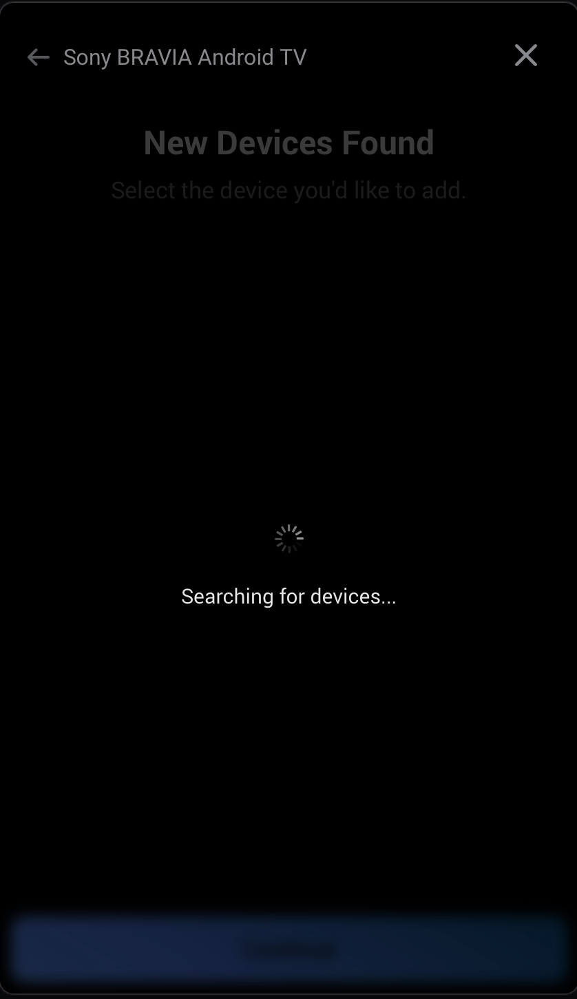

I also have the same problem as @RezaRose. I always get “Network request failed” text. I have an XR-65A83k and a KD-55A8. Neither of them are foundable.
Hi, can you please insert some screenshots of your pair process? Where exactly is the error shown (before or after PSK view)? Thanks.
Edit:
Is PSK access allowed in TV settings?
  • Set “Authentication” in order to use Pre-Shared Key
    [HOME] Settings Network Home network setup IP control Authentication Normal and PreShared Key
For details:
I get the error before the PSK view. I click the green connect button and it starts to search and after that i get the “Network request failed” error message.
Yes, I made PSK access available on my TV.
