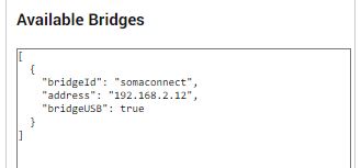

After adding a new Soma device, I can select my 3 devices. After selecting these 3, the devices are visible in my Homey Device list with a red exclamation mark: “Device unavailable, HTTP error: not found”. My 3 devices are online and work with Google Home commands and Soma app.
I have checked the USB bridge option.
Perhaps it has something to do with the battery level and shade state. The command in the log says "“http://192.168.2.12/get_battery_level/ca:18:e8:xx:xx:xx”, but for the USB connector it has to be “http://192.168.2.12:3000/get_battery_level?mac=ca:18:e8:xx:xx:xx”. The same for the parameter get_shade_state (please see Soma Api description)
