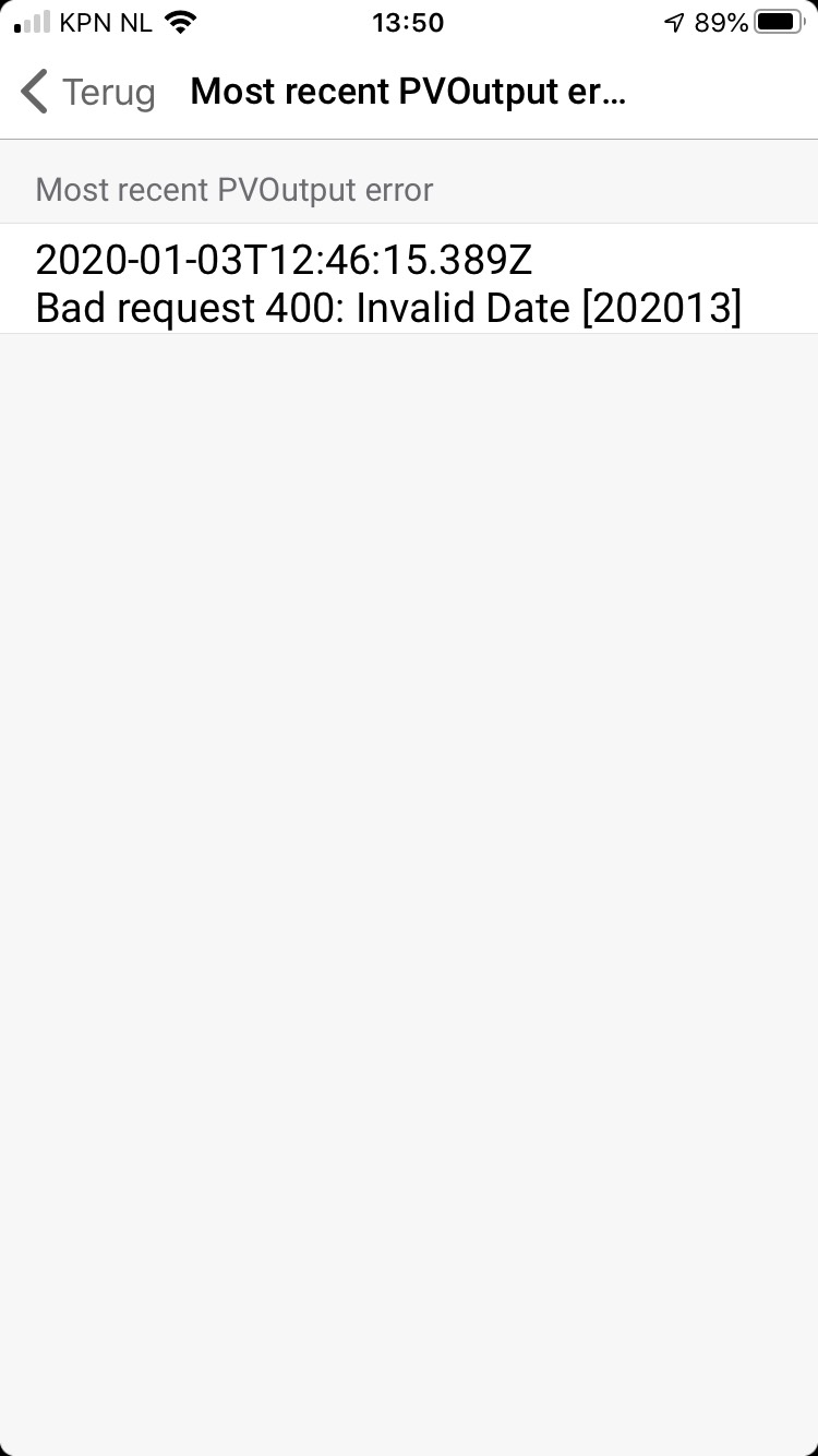

I tried to connect to PVoutput today but got this error message, any ideas how to solve this?
Yes, a basic error from some PV output code I found and use which obviously doesn’t behave correctly. Will issue a new release.
Thanks!
I get every 5 min an update but most of the time no values.
The 5 min interval is configurable and also the start/end time every day. PVOutput, however, seems to ignore zero values after some time which makes sense at the start/end of the day. They also have a cap on the number of API calls per hour if you don’t donate money to them.
The values sent to PVOutput are in each API request;
  • Daily yield
    The energy accumulated so far during the day, up to the time of the API request
  • Power
    Current power at the time of the API request, if no energy is produced at that exact point in time this will be 0.
  • Voltage
    Current voltage at the time of the API request, if no energy is produced at that exact point in time this will be 0.
Values like efficiency, average and normalized are calculated by PVOutput. If your daily yield, meaning energy value, isn’t changed in a 5 min period, this means that you haven’t produced any energy in this period. All the way from 14:40 to 16:15 both current power and voltage are 0 - and we see in the energy column that it hasn’t increased - so no energy production during this time. If we look at 16:15 - 16:20 your daily yield went from 0.980kWh to 1.070kWh, and we also have current power at 14W and voltage at 235V. So in this period, we have some production.
Thanks for your information. I changed the interval to 15 min and see what will happen tomorrow.
With a 15 min interval it works prefect. Thank you!

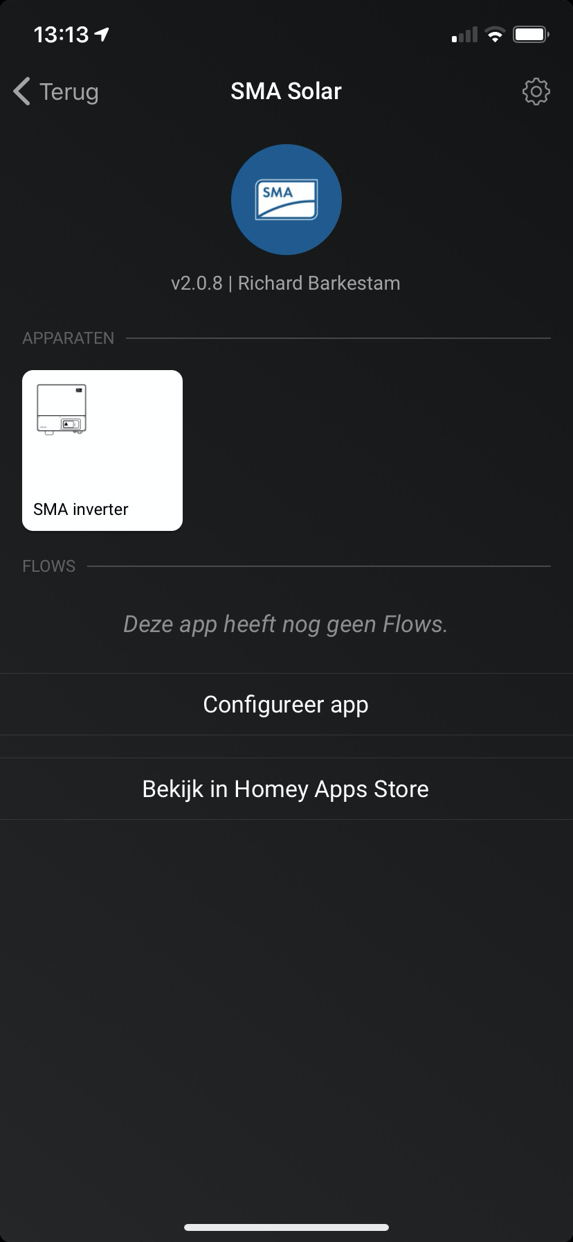

Any idea what’s goes wrong here?
Settings in Sunny Explorer
Settings in Homey
But I don’t get data it seems
Probably something stupid from my side :crazy_face:, but can’t find it, so a little help is highly appreciated, thanks!
Ps; I already restarted the app in Homey multiple times but does not seem to fix this
@Danny_Mertens,
Did you use the SMA Solar app for this (Richard Barkestam)?
SMA Solar App
I miss the information part in my screen shot of the app.
If you did, restart the app. Maybe this wil trigger the data input.
Hi, Yes I did installed the app, and restarted the app already multiple times but this is the only information I get in the settings, and no data in the device itself, maybe this depends on the inverter?
I’m using a Sunny Boy 1.5
