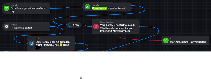

I have a autoexec flow that starts whenever my Homey Pro is (re)started :
Yesterday app. at 11:40 I sgutdown Homey for a USB backup, the restarted… Everything worked fine, the Autoexec flow ran until the end. …. but today I noticed Simple (sys) log did not create any entries after that :
But tonight at 1:00 it suddenly started ?
It looks like Simple (sys) log did not start ? But there is no way to know since I don’t have a log…
And why didn’t I get an errorhandling restart of the flow ?
Could it be that the Simple (Sys) Log app had not yet started when the flow was executed?
Instead of the ‘Homey Pro is started’ card you could also use the ‘Homey system is running - All activated apps are ready’ card:
Thats why I test with the error on the first card with Simple (sys) log.
I’d expect the flow wouldn’t continue when Simple (sys) log wasn’t running. But it seems it does.
Maybe I should install Sysinternals and use that card..
So this should work ?
Yes it should. I had a similar issue with the Simple (Sys) Log app and some other apps. Also you never know in which order Homey starts apps. So I ended up using the sysInternals card, which works (at least in my case) and triggers only when all apps have started.
