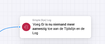

When i now write a log and want to view it I get an error:
The betterlogic app is installed…
Where can I view the log files which i created a flow card:
Screenshot 2023-06-06 114208
What happends if you restart the SimpleLog App?
that worked :slight_smile:
