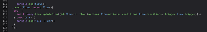

I barely dare to write this, but… I own a Pro19 and
the script returns errors for standard flows unfortunately, it adds no SSL cards yet.
One flow has a conditional card, the other has not, it’s just a ‘When Then’ flow
I hope these console logs are of any help:
It points to these lines of code
I’ll PM a extended console log, Arie.
