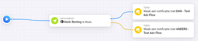

Finally got the time to experiment wilt the automatic adding script, @Arie_J_Godschalk
Still having difficulties with it. I probably don’t understand it full and/or am doing something wrong.
When I change the following (which should only give me cards for THEN and ELSE if I am correct):
const positionErrorCards = { y: -3, x: 1 }; //Number of blocks relative from the card to which it is appended.
const createErrorCards = false; // = true, automaticly create logging card for each error in the selected (or all) flows.
const deleteErrorCards = false; !createErrorCards; // = true, delete all automaticly created logging card from the selected (or all) flows.

const positionActionCards = { y: -3, x: 1 }; //Number of blocks relative from the card to which it is appended.
const createActionCards = true; // = true, automaticly create logging card for each error in the selected (or all) flows.
const deleteActionCards = false; !createActionCards; // = true, delete all automaticly created logging card from the selected (or all) flows.`

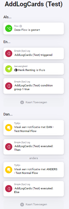

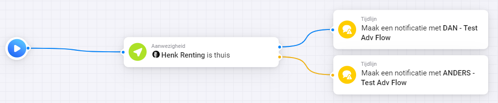

It creates the following in my testflows:
(Condition cards too)
(So none in the Advanced Flow)
I am sure the flownames are correct. When I don’t modify the script (only the 2 flownames) it does add multiple cards in both flows…
What am I doing wrong / am I misunderstanding?
I think i didn’t add the create***cards to the normal flows, just AF.
So in normal flows, all cards are always created.
Ill fix it in the next release.
That would be great, @Arie_J_Godschalk. :+1:t2::smiley:
And for the adding of AND/Condition cards, although I assumed I disabled those?
For AF you have disabled them, yes.
For normal flows, you cannot disable anything yet.
I see, thx. That explains the behaviour for normal flows.
But there is no card created at all in advanced flows, see screenshot above. I didn’t disable the Action (THEN and ELSE) cards (I thought). Or did I do something wrong there?
No, it doesnt look like you did anything wrong, but perhaps i have a bug in the script woth the create***cards. Ill check it when i can.
Great, thanks again for all your hard work. Really appreciated!
