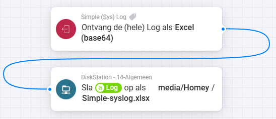

Receive the whole log file suddenly gives empty files.
It worked fine, but since the 19th of june I have not been able to extract the logfile via the method Receive the whole log as Excel (base64)
Simplelog01
The file is always empty now.
Export via the configuration of Simple (sys) Log goes fine, but I want to have it automated and I want to do some maintenance on the logfiles.
When I try to get the logfile with CSV I see that there is data in memory.
Simplelog02
The directory media/Homey is on a synology and nothing changed there.
I have Simple (sys) Log and BLL updated via autoupdate but near the 19th of june I haven’t seen an update that could explain a change.

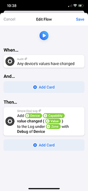

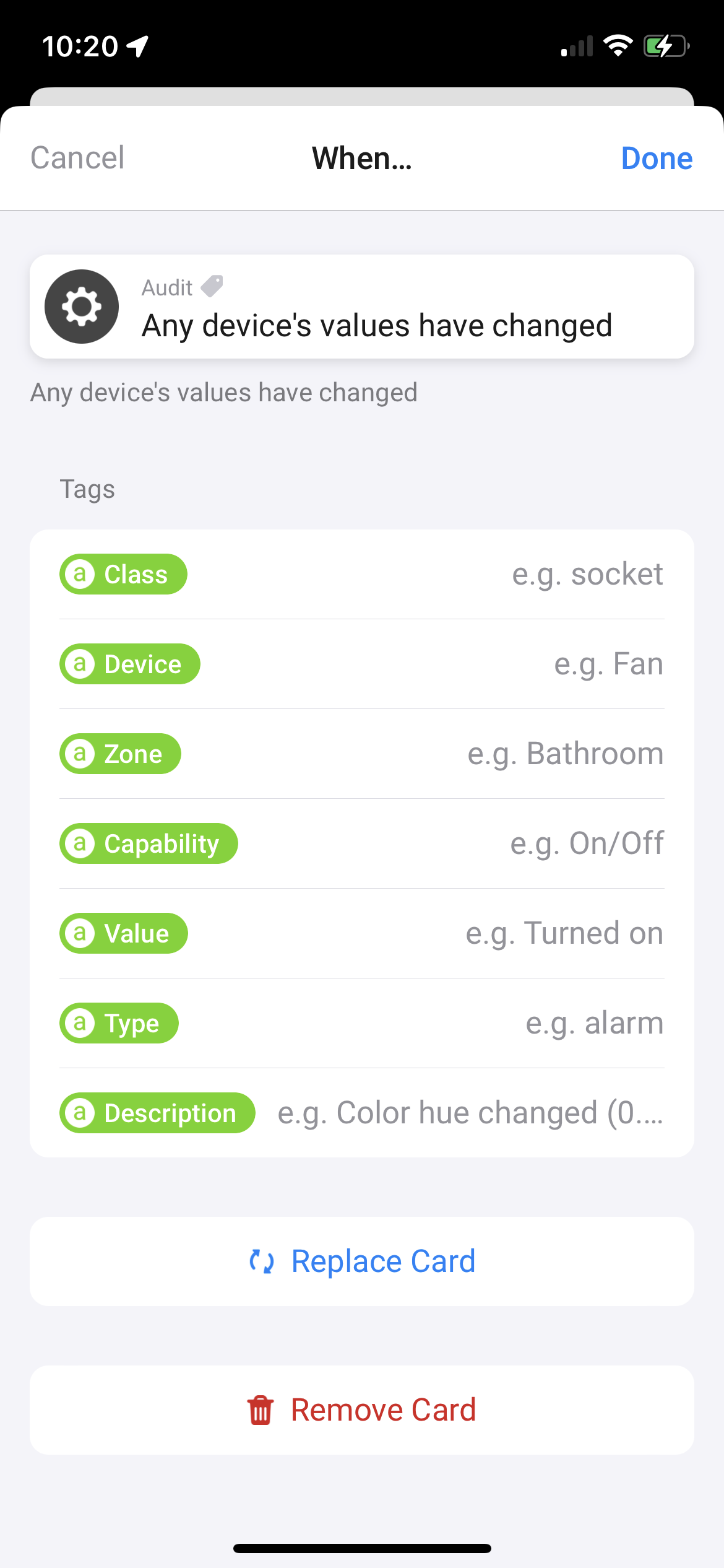

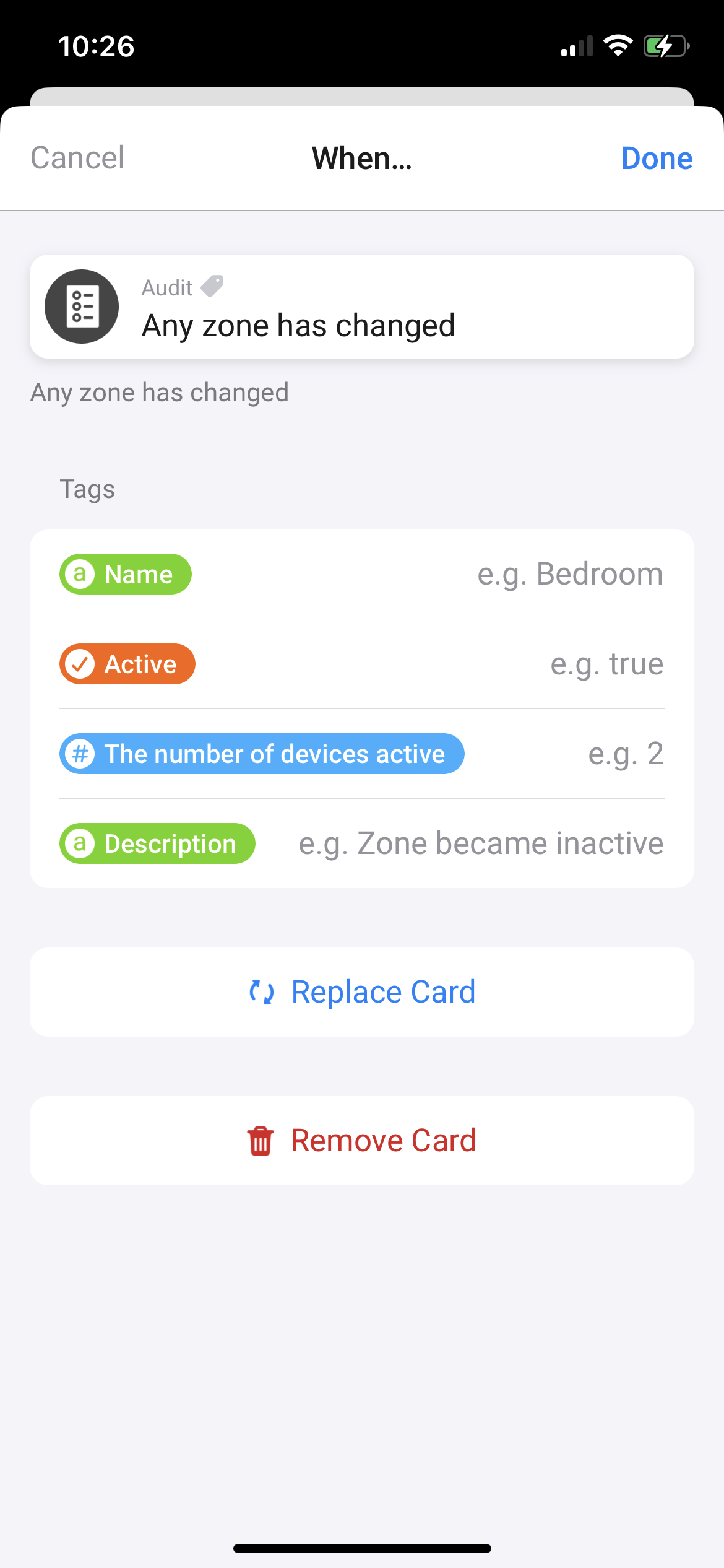

I have an app which you may like, it tracks all device, variable and zone changes and outputs tags. Which I then use with the Simple LOG app to log … everything.
You can then use just three flows to log … everything.
Let me know if your interested.
