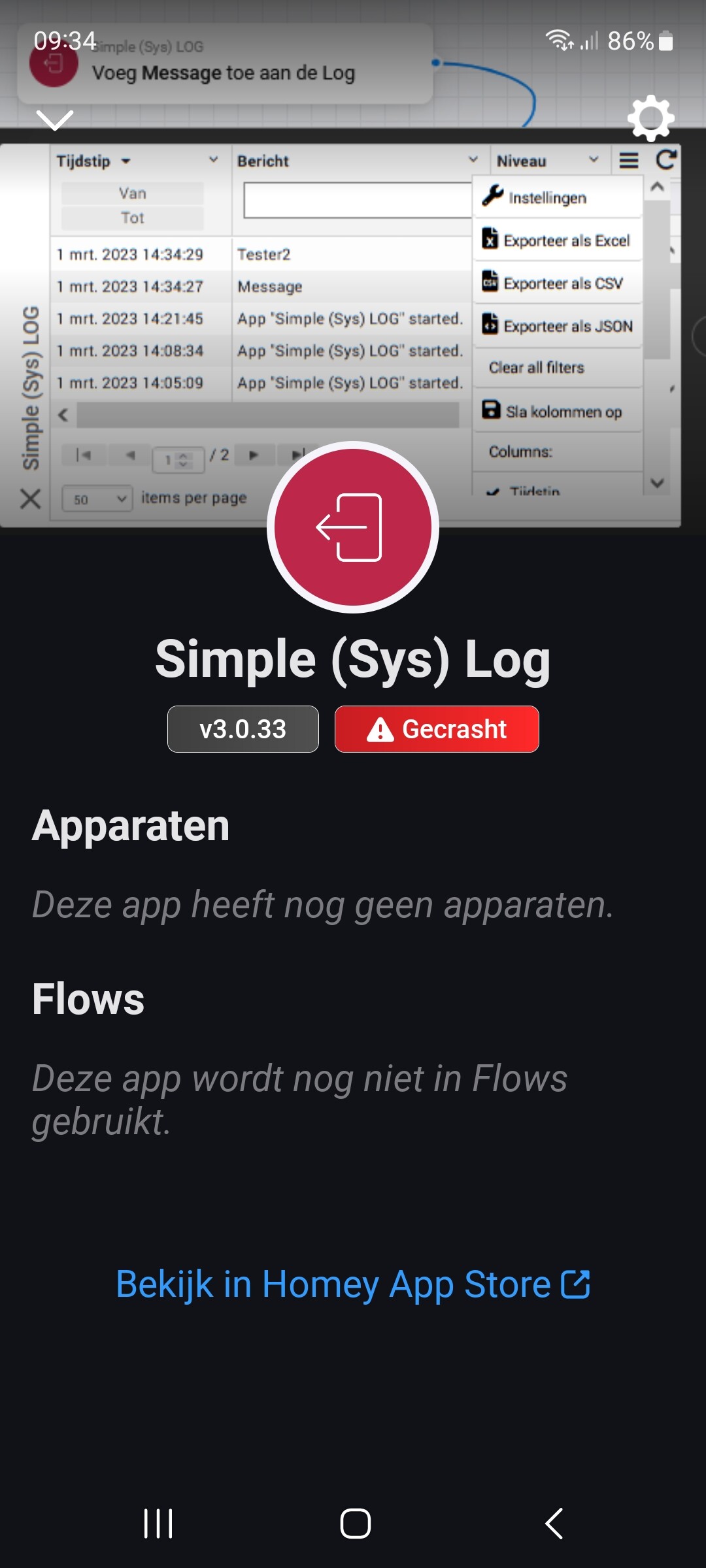

Hi @Arie_J_Godschalk,
When I try to export to a CSV or Excel file the Simple (Sys) LOG app crashes.
I’m running on app version v3.0.33.

How many log entries do exist when exporting? I think it should be below 10,000 entries

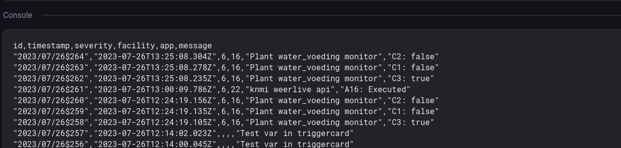

Ah great! That made my csv conversion work. The ‘logs’ part was messing things up but I couldn’t find a fix
// define url
const url = "http://192.168.1.223/api/app/nl.nielsdeklerk.log/";
// get data
let data1 = await fetch(url);
// make it json
let dataJson = await data1.json();
const table = dataJson.logs;
//console.log(table);
const replacer = (key, value) => value === null ? '-' : value // specify how you want to handle null values here
const header = Object.keys(table[0])
const csv = [
  header.join(','), // header row first
  ...table.map(row => header.map(fieldName => JSON.stringify(row[fieldName], replacer)).join(','))
].join('\r\n')
console.log(csv);

Far beyond the 10k entries (31.695). It would be possible that this is an issue. But I do not prefer to delete my messages now. Hopefully, there is a solution to still export them.

Hmmmm I recall having a similar problem, Arie asked to clear up the logs and keep 2 days or 1 day (back then the number of lines were not available). After that, the export succeeded.
My guess is Homey memory system can’t handle that amount of data.
Maybe Arie can make exporting a selection possible one day, while I can imagine you don’t want to lose your logs, but want to shrink the log on Homey.
Like, “export today’s logs”, or export “yesterdays logs” etcetera.

Which Homey do you have? Hp2023? Or previous model?
Where can I find the support site for Simple (Sys) Log?
HP2023 indeed.
The link is in the top posts of my topics:
https://bitbucket.org/QlusterIT/nl.qluster-it.simplelog/issues?status=new&status=open
Well, on the HP2023, i have been able to generate excel files with over 150.000 lines, so that should not be the issue.
However, before i can fix this, i first am waiting for the HP2023 to function more properly (then the last time i migrated), and i am currently updating the Device Capabilities app to the new homey-api.
This takes up all my homey-time atm, and next week i have another holiday.
So, yes i will fix this, but i don’t expect to be able to fix it within the next 1,5 to 2 weeks. Sorry.

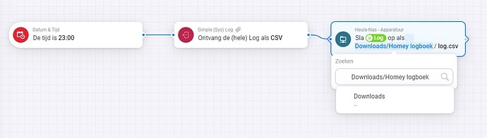

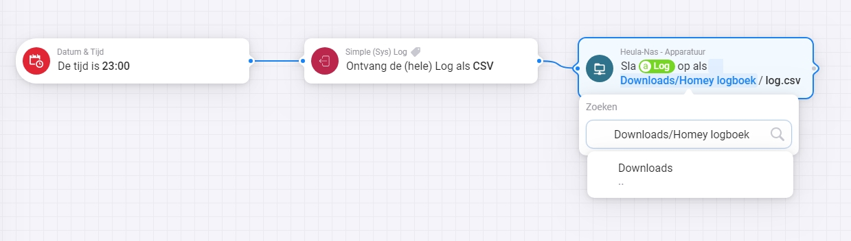

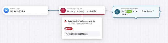

For some time now I have been struggling with exporting my simple log files to my Nas.
For some time now I have let it alone but today I thought, let’s have a look again if it will work but unfortunately it stil doesn’t work for me.
The Simple log app just crashes when I run my flow.
Tested with all available options and with all of them it does crash. The export card works just fine and I see a log file in my destination folder. That file does contain all kind of weird text but that must be because of the card that causes the crash?
This is what is inside the csv file.
u«Z
Wš­çZ–Yh‚§Ö­j
躔¢š™^.ˆj×¶Óm¾×o¶õ==ßÍôۏYu«Zm§djg«ëGZµí´ÛoµÛí½OOw÷}µïf
u«Z
Wš­çZ–Yh‚§Ö­j
b99c5d1d-e935-42c7-a4b6-905fc2a64385
