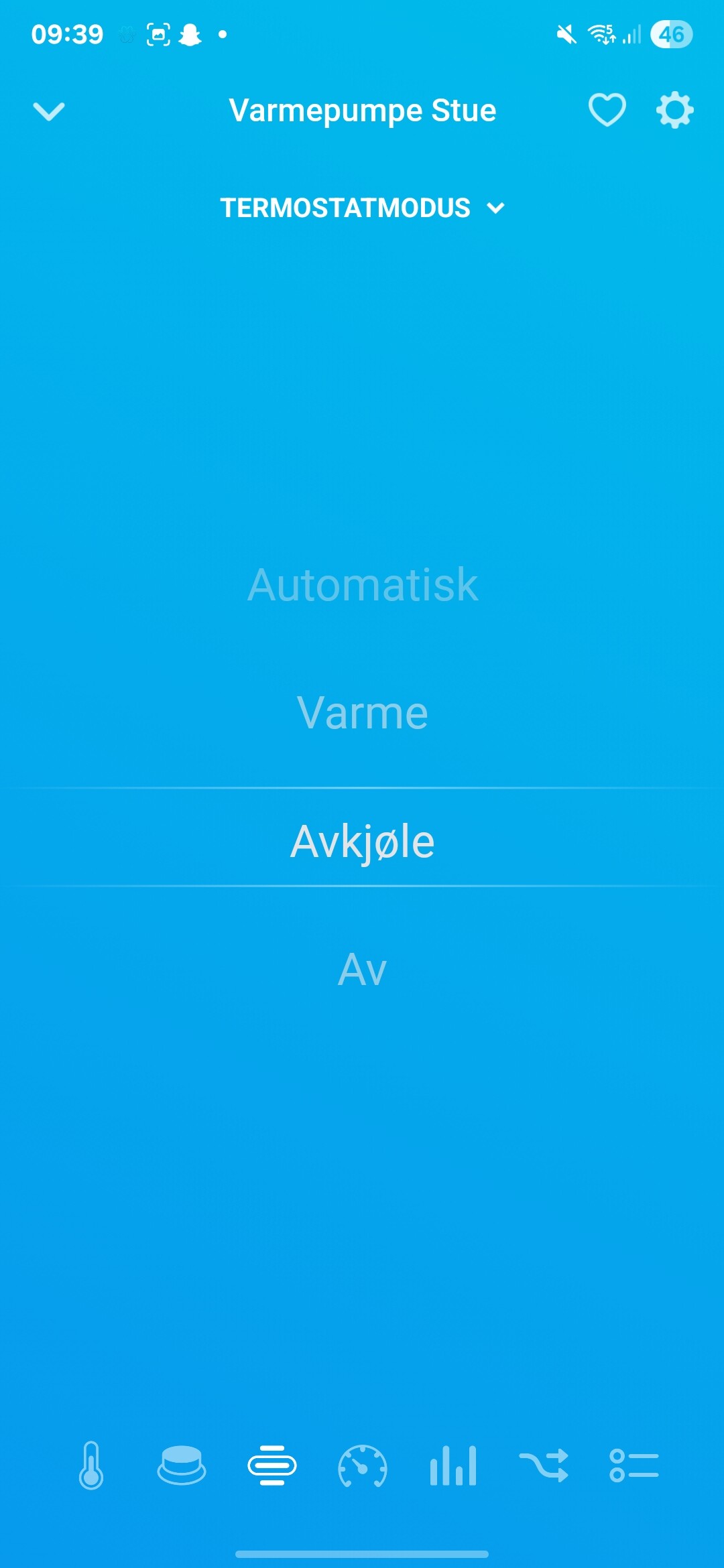

I’m wondering about this too.
It would be great to be able to select fan mode directly on the device. Also be able to check if the AC is on fan mode in Advanced Flow.
Here are the options I have to check the AC mode,
Auto, Heat, Cool, Off (Fan is missing)
I´m also missing fan level “Strong” everywhere in homey.

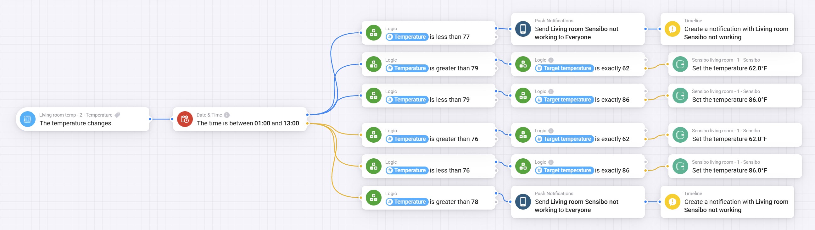

Hello I would like to feature request for Homey pro to be able to change Climate React setting please.
As of right now only can turn on and off the climate react can not change any setting
All (Inverter type) mini split have problem with reaching to set temperature target fast
for example
at 1PM 100F outside if set temp to 76F. mini split it will take around 1-3hr to reach to set temperature.
but if set temp to 62F. mini split it will run only around 5-10mn to reach to set temperature.
Climate React feature help me solve a problem
I set
when temp goes above 76F set temp to 62F to reach set temp fast
when temp goes below 76F set temp to 86F to stop running
It would be nice if Homey pro can set Sensibo Climate React
at 1PM
at 1AM
when temp goes above 79F set temp to 62F
when temp goes below 79F set temp to 86F
because at 1PM feels perfect for 76F and at 1AM 79F feels perfect
as of 76F is too cold at 1AM
This change Climate React setting feature is available on Sensibo app for pay subscription
but the down side is that you can not use Homey pro to double check if
at 1PM did the Climate React really set to 76F
or 1AM did the Climate React really set to 79F
because so many time the WiFi down or drop or power outage or power drop for a second
Sendibo will not work without connetion or will not control anything and when it reach 1PM or 1AM setthing did not trigger
I could use Homey to set the temp but the problem is the connection between Homey and Sensible is not working 100% of the time it more like 80%
for example Homey tell Sensibo set to 62F but Sensibo did not trigger.
and everytime when I want to change temp it’s so hard and many step because it’s in advance flow I have to use the web
right now I use Homey to turn on and off Sensible Climate react and let Sensibo Climate react control temp it working around 98% of the time
easier to change temp with Sensibo app
Thank you
