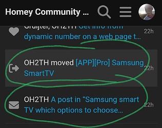

Dear Rudi, I’m old but not retarded (yet) :rofl:
I understand your thoughts, but the original post was not posted in this app topic at first.
I assume you are familiar with the habit of users just starting new topics for whatever?
When posts were not posted to the appropriate app topic at first, I occasionally flag it with the request to move it to the correct app topic, along with the link to the app topic (after asking the TS what app is involved when unsure)
This was pointed out as the preferred way to by moderators
Then, a moderator decides what to do with it, and often those post(s) (including my responses to that post) , are moved to the appropriate topic.
But it is not visible marked as such here, you only can see it with the original topic, IF it isn’t closed already.
I do this stuff at free will, so I guess I’m a bit of an idiot anyway :laughing::sweat_smile::laughing:
