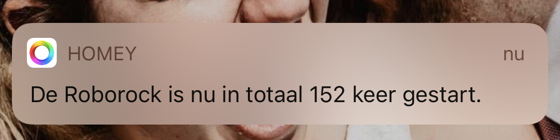

Last but not least… Also got the status update from the S6 MaxV.
