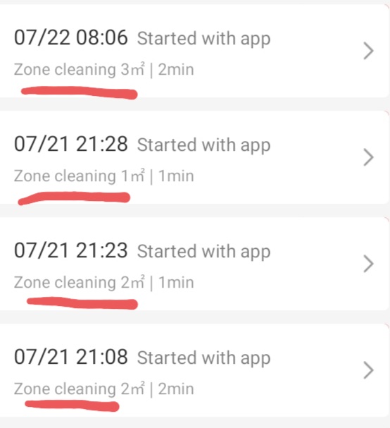

I have tried several times. First I confirmed the coordinates with Move to target and then put them into the card Clean the zone. When I check cleaning history in Xiaomi app the vaccum starts Zone cleaning but it is not going to the entered coordinates. Instead it starts cleaning close to the wall to the right from the dock.
I noticed the same thing but thought I was doing something wrong. It is saying ‘starting zoned cleanup’ right?
Yes, it says it and it is also logging it in mobile app cleaning history. Something must be wrong with coordinate handling?
