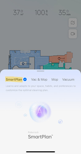

Regarding the “SmartPlan” - I have the Qrevo Curv model and in the App it shows different types of cleanup modes as per;
I can call upon the “Vacuum” only by setting the Scrub intensity to ‘off’ and “Vac & Mop” by setting it to anything other than that.
I have not been able to set it to “SmartPlan” though. I tried playing around with some of the commands such as “set_customize_clean_mode” but without documentation on the input it expects I don’t know if that’s the right option to use.

Related to the SmartPlan, the command I guess you need to use is:
set_custom_mode
You can use this in a flow with the raw command, and use the following as an argument:
[ 101 ]
In my experience, it is a number 100+, the largest value I’ve seen is 108, but by trail-and-error and comparing the output from the Roborock app you might be able to find out the exact value needed. If the robot does not know the value it will not give a “ping” notification sound (if you enabled it).
Additionally you might have a look at the settings too, there is now also a state entry, which shows the raw output from the get_status command. You could try enabling the mode in the Roborock app, then wait +/- 5 minutes (= sync interval of this app), look into the settings and copy the contents of the state. That information might help me in determining what values might be helpful. You can provide that info to my by PM if you want.

Thank you Kenny. Two interesting finds;
  1. The Homey Roborock app itself now actually allows for setting the Smartplan manually but not through the “set scrub intensity” “then” card;
Would that be an easy fix from your end?
  1. I’ve found the status of the Smartplan mode and it’s under “scrub intensity” with a value of “209”; image
however, not a single Method command takes this paramater. Tried; set_custom_mode, set_mop_mode and others but none return acknowledgement or show successfull changes.
UPDATE on Point 2: So, when the scrub intensity is set to 209 (SmartPlan), none of the commands are accepted, not even from the other cards or in the Homey App. If I (from the app) change the SmartPlan and into anything other, then I can use the Methods and other cards successfully. With the “set_water_box_custom_mode” Method I can set it to 209 and then it changes successfully to Smartplan, however it does not acccept any methods again after until I manually change it. It seems as if the Smartplan breaks the Homey Roborock app

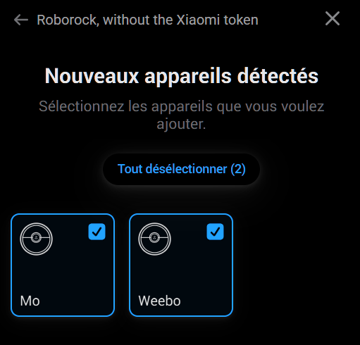

I think it’s the last version but I had a problem in the meantime, I had to delete the app from Homey and reinstall. Except that I can no longer reconnect the robot… it gives me this message:
I don’t know what to do :sweat:
I am getting this error also. Using a S7 Max V.

I just discovered this topic and installed the app. I have 2 robots (S5E + Qrevo Master) both connected to the Roborock app.
I have the same error reporting that I got connected on another app and homey is giving failed to retrieve the user token :grimacing:

Hello guys,
I’ve pushed v0.3.3 to test, and submitted it for certification. This version should fix the login issues.

@MichelW
If you authenticate with the Homey app, you will receive a notification on your Roborock App that you logged in on another device, that’s normal behaviour. The fact that you could not login was a bug, which is resolved in v0.3.3.
