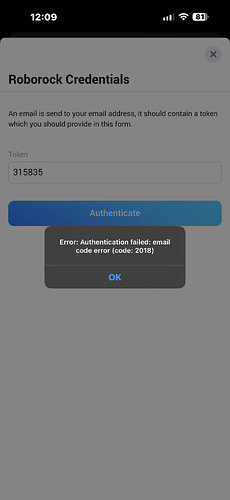

What is the text of that error code?
Hey @Hans_Heintz
Token log-in worked for me.
Token login worked for me as well
Error: Authentication failed: email code error (code:
Prev post copy pasted from a text extraction on my iphone and strangly formatted. The error code is 2018

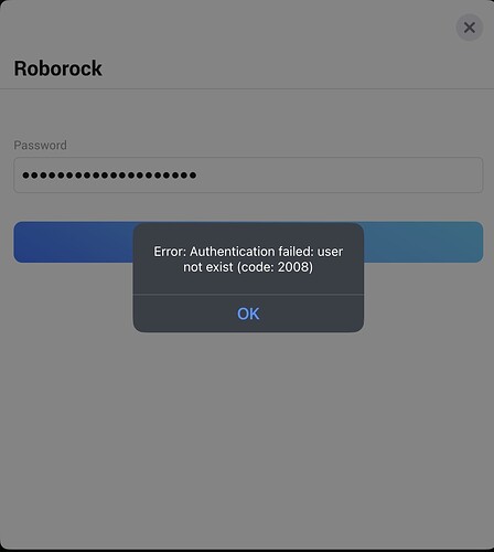

Hello guys,
The password login flow is currenlty broken. I will investigate later this week for finding a solution for that, for now you can only use the flow “login with token”.

Hey @Mark520
Please try using the token approach, the password approach is broken and will be removed with next upgrade.

Hmmm - are you sure you are using the right email address?
I have successfully connected Roborock skill in Alexa with the same credentials.
