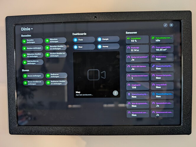

I noticed that since the last version and even with this new one, the map is no more available for me, a black screen is displayed instead
An issue or something I’m doing wrong?

Now the icon is no more available, very strange indeed.
Find below the diagnostic code:
f0c0d841-79f0-452a-a695-a91bcac0a40c
Regards
@KennyMoens map doesn’t work here either, I wasn’t test user so the map functionality just arrived for me with the 1.0 update, and it didn’t work from the beginning. Keeps refreshing. Restart of the app doesn’t help.
Diagnostic report:
aeb21608-8a35-4010-9e44-400484445e54

Good(?) news, I see the same in your diagnostics report as in the one of @Arjank95. The bad news though is that I don’t know what is happening.
I’ve pushed v1.0.1 towards test, this version will most likely not fix the problem, but will give me more debugging information.
Can you guys install this test version, and submit me a diagnostics report again?
Thanks!
Did what you asked, still not working indeed, but great that you’re diving into it!
99bfcbd8-1a37-4db8-81a3-e8271dab3399
@KennyMoens updated the report
@Arjank95,
Could you resubmit one? I think you submitted it too fast after the restart of the app.
Thanks,
Submitted this one
85b40888-9616-4602-979b-40354a853237.
Thanks very much for the support
Hey guys,
I’ve pushed v1.0.2 to test.
This release should include the following fixes:
  • Map rendering should work again for all devices, for some reason (older Homey model?) the rendering of the robot’s location fails with @Moussa_BA and @Arjank95, I suspect due to their Homey model. I’ve now added some error handling, the map will render, but the location of the robot won’t be shown in this case. I’ll look further if I can add some compatibility for older devices…

@KennyMoens thanks for the effort you’ve putting in again. It shows the map now of the last cleaning routine! Like you’ve said: not the location of the robot, but that’s not the most important thing for me.
Hi @KennyMoens ,
Just testing it and it works like a charm.
Thanks again for this great application, we really appreciate it.
