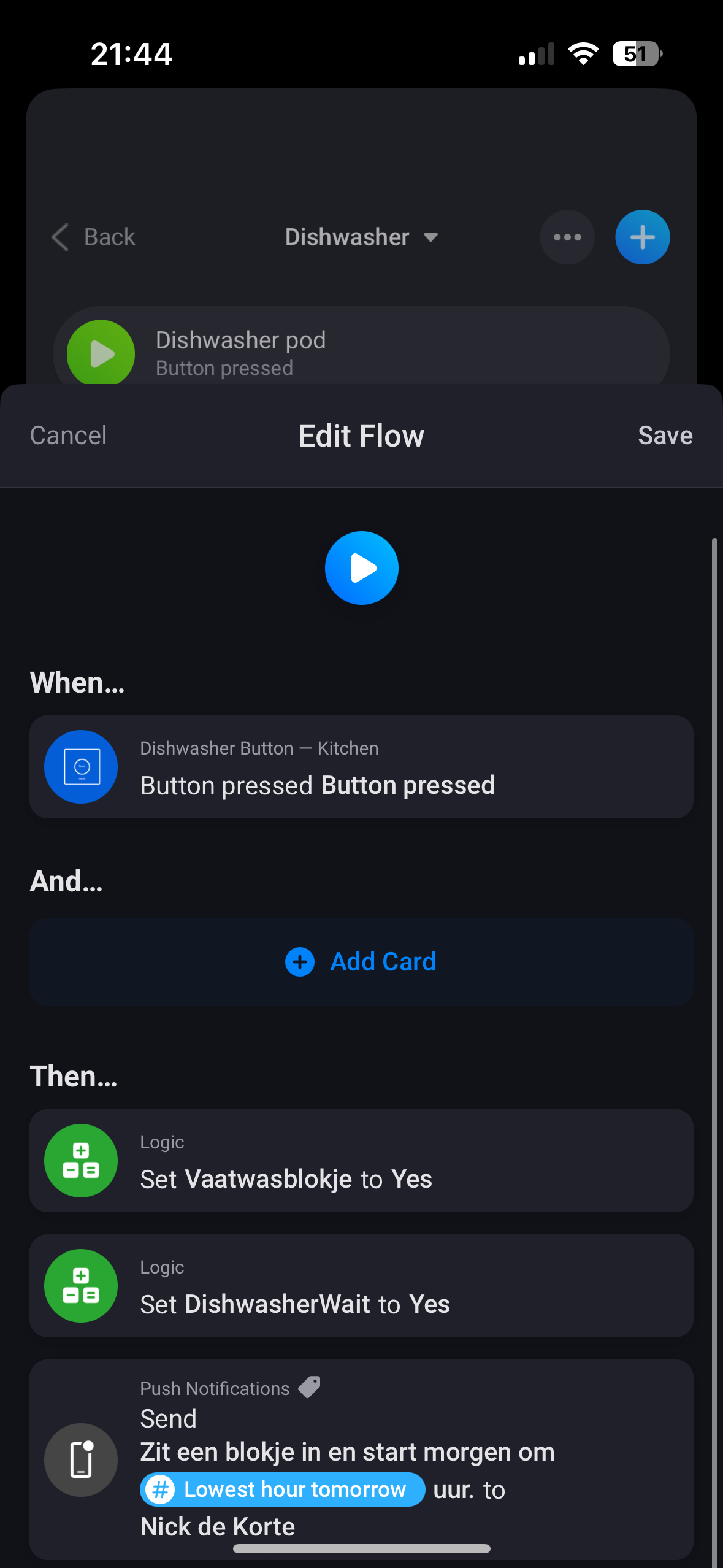

I use Tibber/PBTH to start my smart dishwasher when the power is cheapest. My gf or I fill up the dishwasher and then press a hue smart button, which triggers logic to be set to yes. Starting from
0:00 the next day, it will fire the flow when power is cheapest and logic is yes.
However I would like to know exactly when the power is the most cheap (tomorrow, we always load the dishwasher ~22:00ish), so I know how late it will run. I tried some things but I either think too simple or too complicated. So when I press the button, I want it to tell me: Dishwasher will run tomorrow 03:00.
Cheers!
That is standard available in flows as a tag (search for ‘lowest hour’ or ‘laagste uur’)

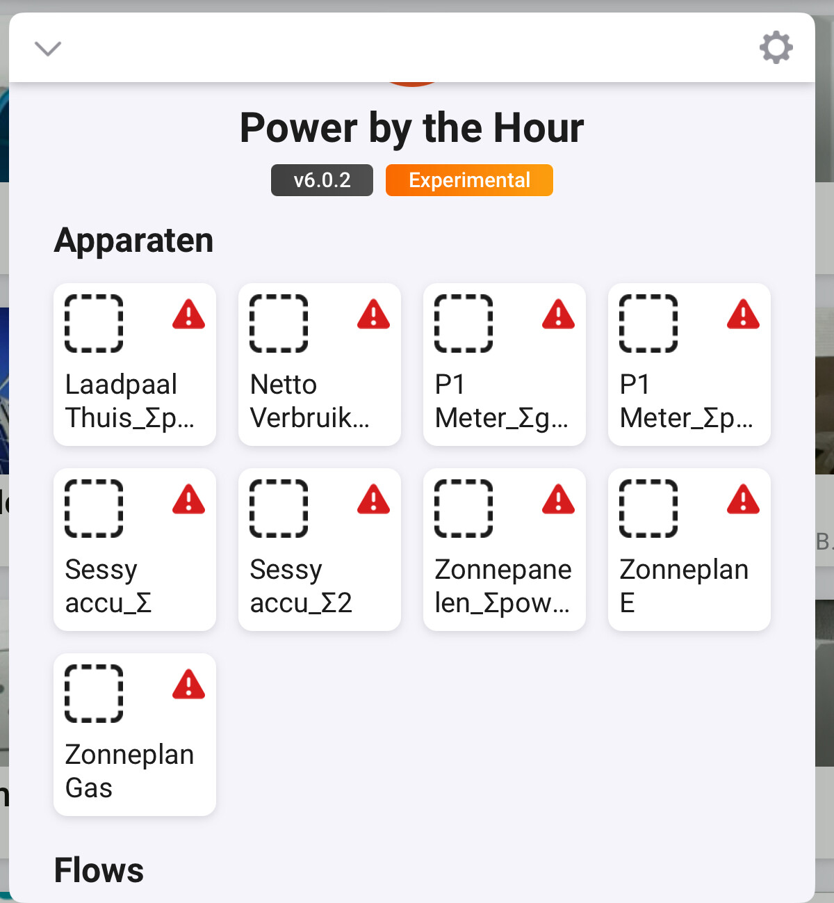

About once a day all the devices of PBTH app show red exclamation mark. Restart of app solves this.
Since new test version with the new battery ROI solver, which I’m using.
6131da39-088b-43a5-add5-95cb32630181
yep, have the same here :grimacing: :frowning:
Disabled the flow for now. I’m investigating.
Edit: seems to be a huge memory leak. But I think I traced it. Anyone that has a BATT device will experience app crashes until a new version is released. (SORRY :smirk:)
Edit 2: The memory and CPU issue is intermittent. Still looking how/where to fix it :frowning:
