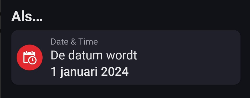

I have this card in my HP19
In my HP23 I have this IF cards.
Both are under date and time.
@RonaldNeed many thx for your kind donation!:smiling_face_with_three_hearts:

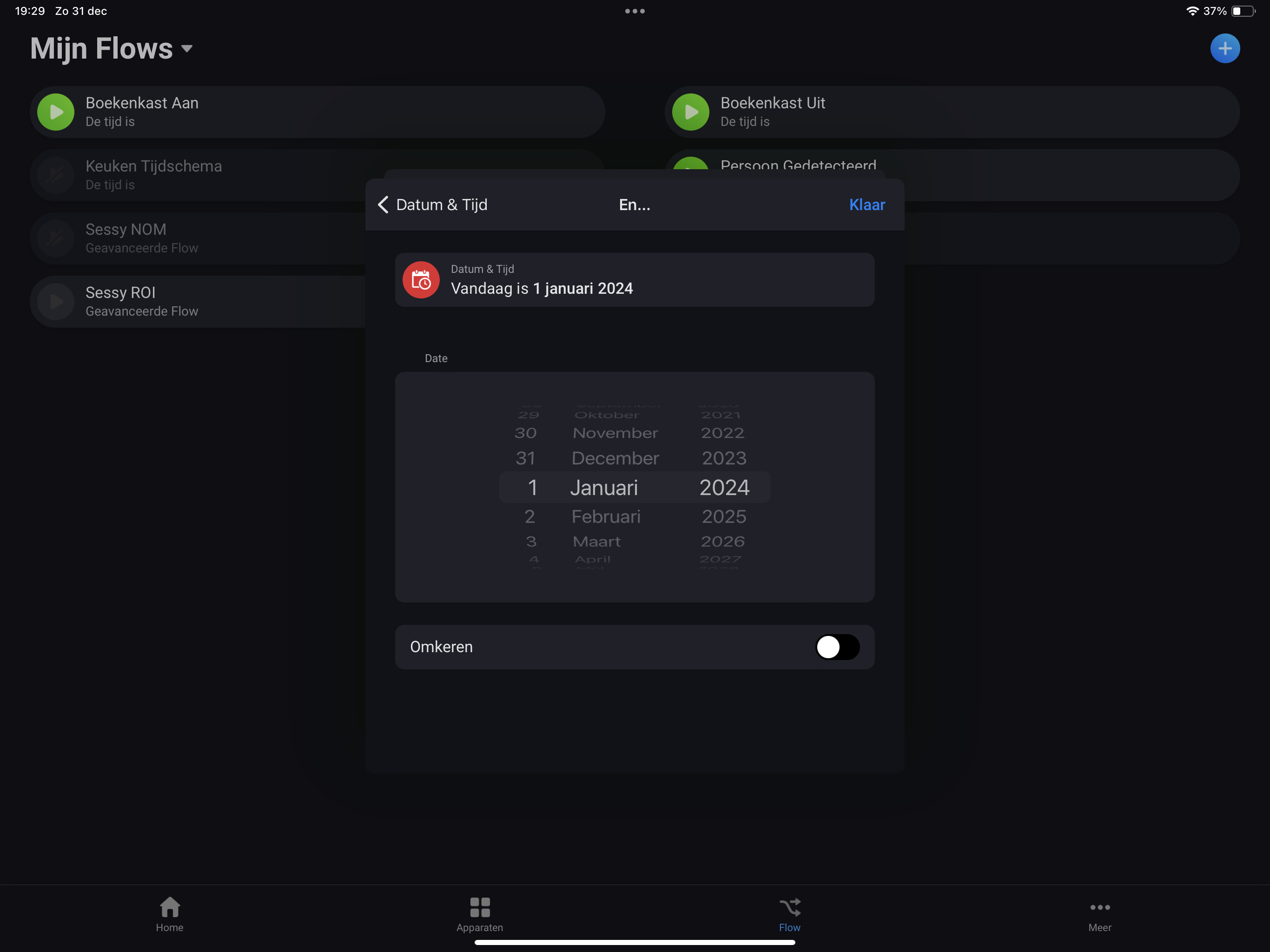

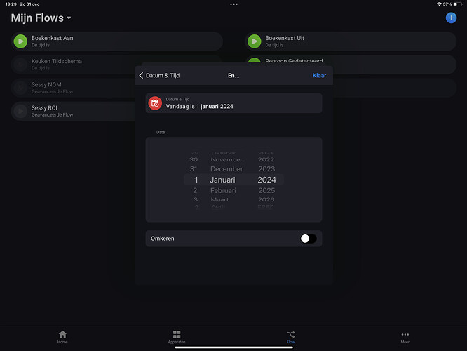

You will find the right trigger cards for the date under ‘then’ and not under the ‘ if’ cards.
@Dennis_Fokkema I think you mean the AND card.
On my Homey Pro 2019 I have a IF card “de datum word…”
And a AND card "de datum is… "
On my Homey Pro 2023 I have only a AND card “vandaag is…”.

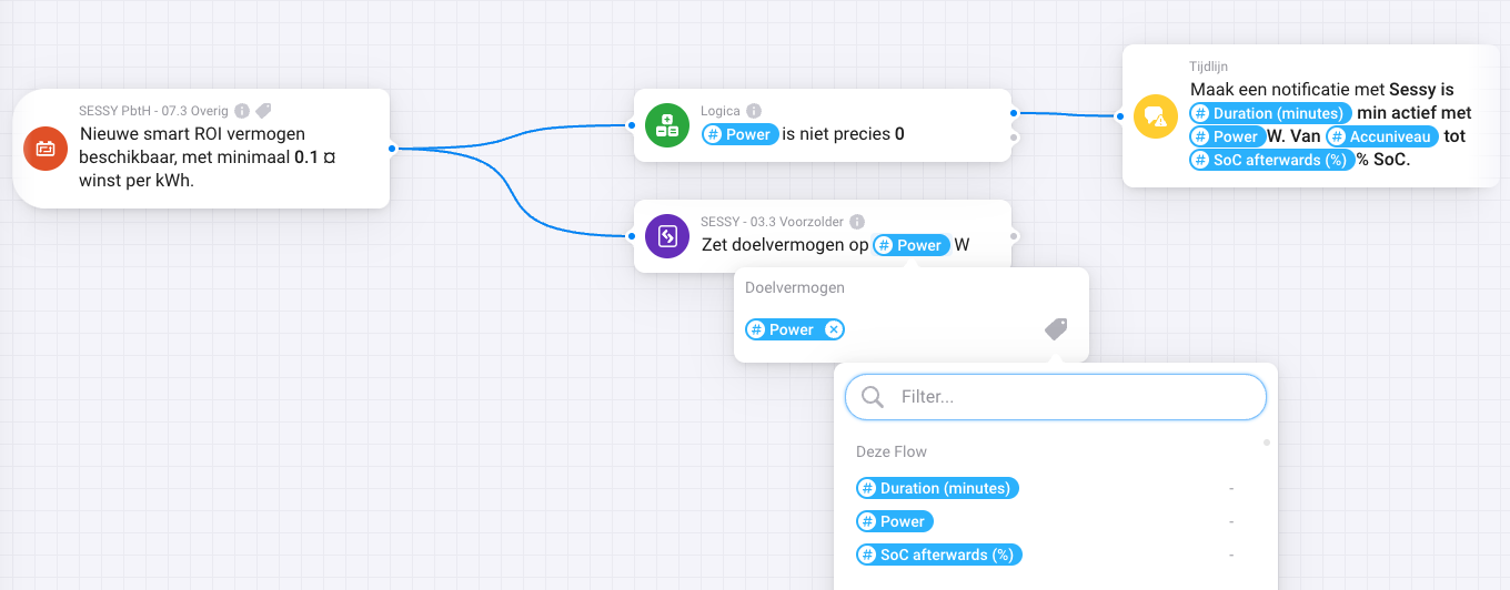

What is not working? I am running it for a few days now, and the new ROI flow works very well for me on my HP2023. It is not working on HP2016/2019, so in the latest test version I disabled the new ROI flows.
Note that you need to set a minimum profit that is low enough to trigger something. I set it to 0.1 cents now, and for today/tomorrow that is enough to start charging/discharging.
I also have a Homey 2023.
In the settings, I have enabled ROI status. However, it does not charge or discharge it.The profit is 0.1 for me as well.
As you can see in the tags, the active commands are completely empty. Could this have something to do with it?
