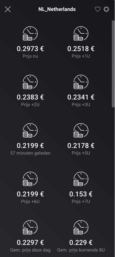

Can you share a screenshot of the Battery strategy (Battery Summarizer device tile)? Just to check: you did set Day Ahead Pricing for your battery I assume?
Yes off course.

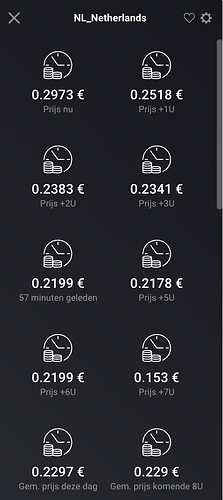

Here are the screenshots.
No, I need the Battery Summarizer screenshots
Sorry,
You need in dutch ‘thuisbatterij monitor’

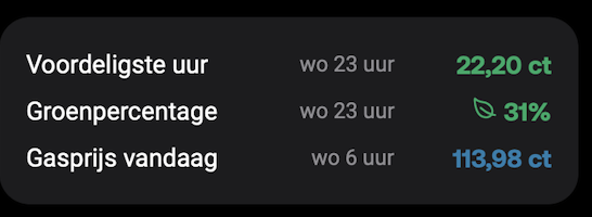

I have a little problem. I have give the price for gas but Homey is telling me that it is 1.141 but my Zonneplan app is telling me that the price is 1.1398
Picture Homey:
Scherm­afbeelding 2024-01-03 om 08.10.28
Picture Zonneplan:
Scherm­afbeelding 2024-01-03 om 08.10.52
Well that is strange, I think it’s an average of the price before 6 o’clock and after?
In the gas tab of the zonneplan app the same price as homey is shown:
That is strange, yes… I see this:
Scherm­afbeelding 2024-01-03 om 08.21.59
And the website from Zonneplan is telling:
I see two different amounts for the new energy tax for gas in the Netherlands for 2024:
On the site from Zonneplan itself (where I got my amount): € 0,70659
And for instance here : € 0,70544
And here: € 0.705
When using € 0,70544 and adding the €0,08 fee, I get € 0,78544
When using this, the gas price is €1.1398, the same as zonneplan app :grinning:
I suppose this is a calculated mean price for the price until 6 am and from 6 am.

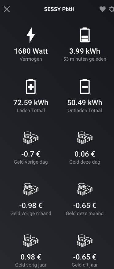

Just to understand. Yesterday, the graph indicated unloading between 5 - 8 pm. Now, with the new rates for tomorrow, it has changed to only today at 6 pm. Tomorrow, it has scheduled unloading again between 5 - 8 pm.
Scherm­afbeelding 2024-01-03 om 14.10.22
that makes sense if your battery is (almost) full, and you have set a profit higher than can be delivered. If you set the profit lower, you will get more action :slight_smile:
