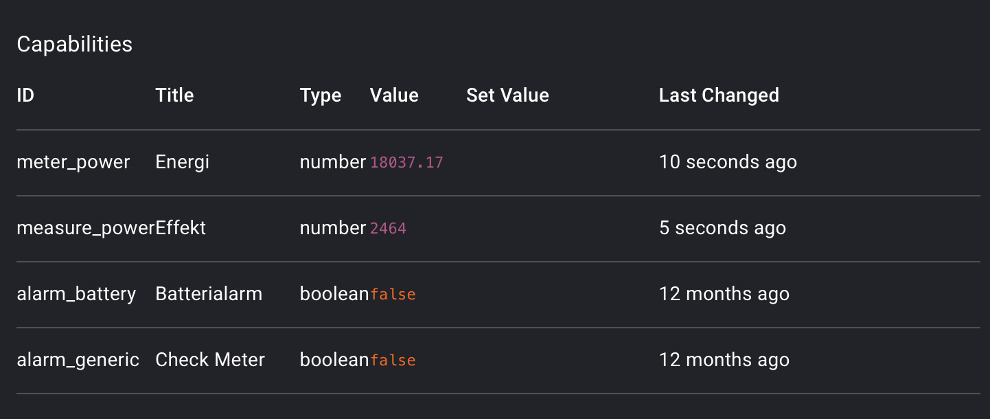

That is not from the Frient device. I need the capabilities from the frient app.

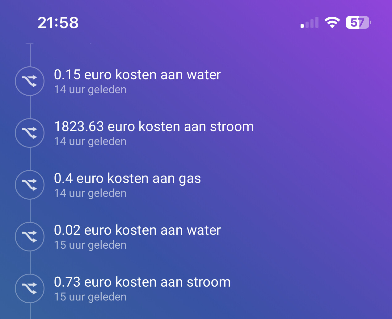

Power price …. Suddenly extreme high
Same here, using HomeWizard P1 meter, suddenly today ( last hour actually) my electricity use jumped and became 1152.54 kWh for the day. Haven’t changed anything. Couple of days ago I noticed that several PBTH devices updated themselves. Had to re-add the gas aggregator, but not the electricity one.
Looking at advanced settings, the meter values seem okay and work out to 15 kWh for the day. But the calculation is off.
There is no way to make the aggregator re-calculate based on meter values, right? Would be a bummer if this messes up the statistics for the week/month/year.

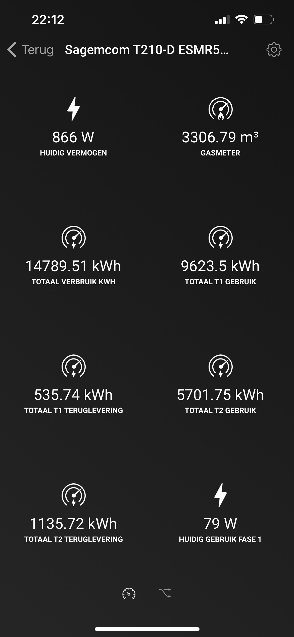

Okay, it seems that the HomeWizard app is off, its meter totals don’t add up. Suddenly there’s 1135 kWh extra. If I add T1 and T2, then subtract the power sold to the grid, I get to 13654 kWh as the current ‘total’. However, the HW app on Homey reports 14789 as the total. The difference is exactly the T2 ‘teruglevering’ amount, it’s not subtracted from the total.
