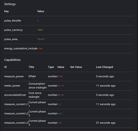

Thanks for the quick response. Here are a couple of screenshots.
No. 1 is a Tibber Pulse
No. 2 is Heatit TRM3 and
No. 3 is HeatIt 16amp Single Relay

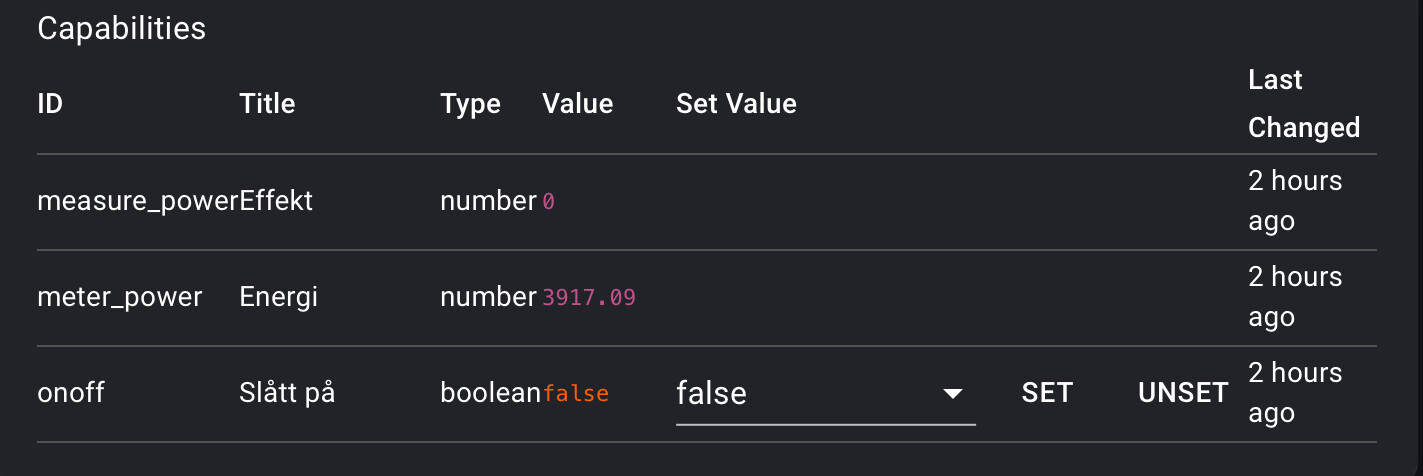

They all show a meter_power capability, so baffling to hear they dont work in PBTH.
Can you post screenshots of the source device info in the PBTH devices?

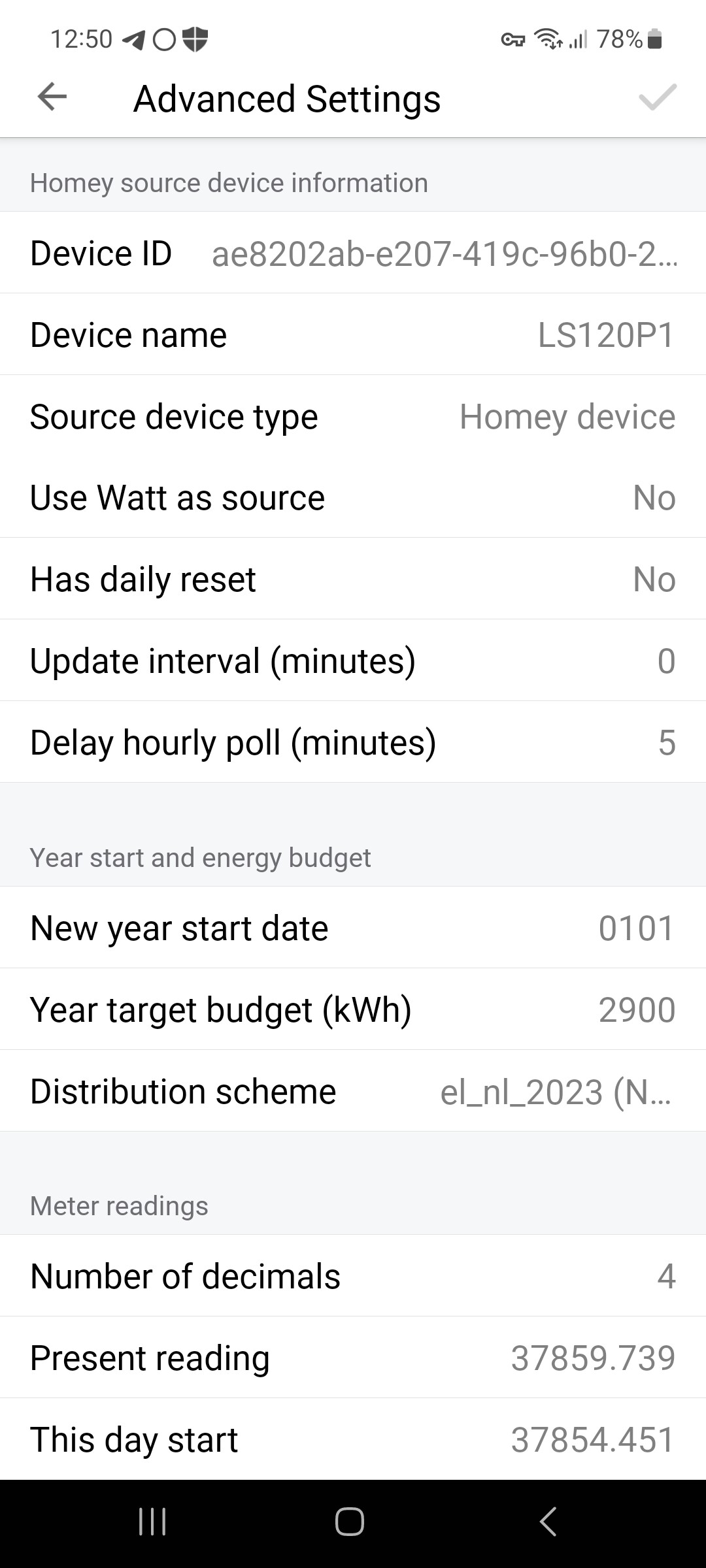

Gruijter,
I found something unusual. When I add a power summariser, it uses watt instead of kWh. I’ve tested t a few times en every time it uses watt.
When I turn it to kWh, the kWh meter standing gets updated. I have to fill in start jaar/start maand manually.

That might be a bug. If indeed during pair or migration it gets switched to using watts when it is supposed to use kWh, stuff goes wrong off course. Will check my code for detecting watts vs kWh source devices.
Thx!
Edit: yes. found a bug for newly added devices. I will push a new test version asap to resolve this.
v5.1.3 is ready for testing
  • Added sourcecaps logging on incompatible meter_power error.
  • Fixed incorrect ‘use_measure_source’ during power summarizer pair.
Now it works. I set the update interval to 0 and restarted PBTH, and now it reads :slight_smile: Thanks!
