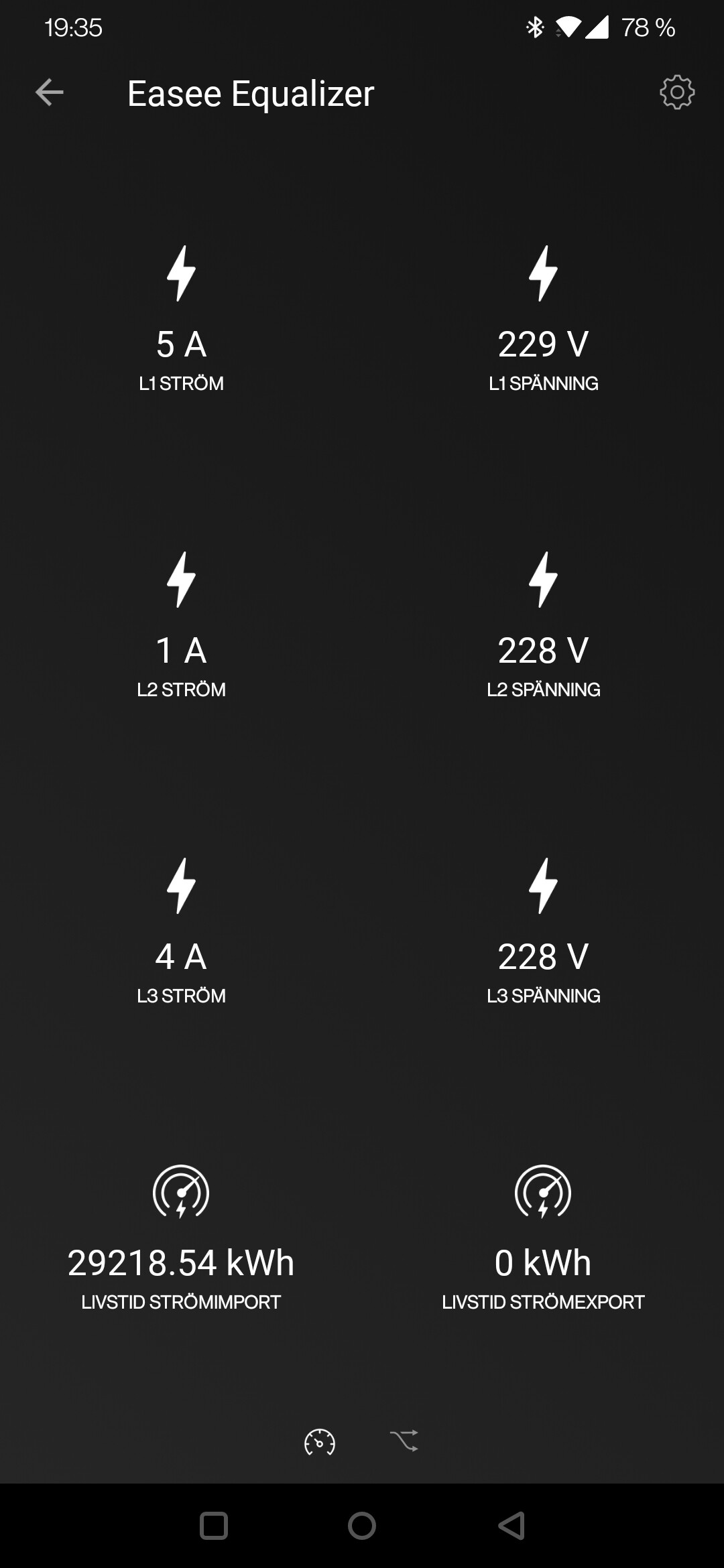

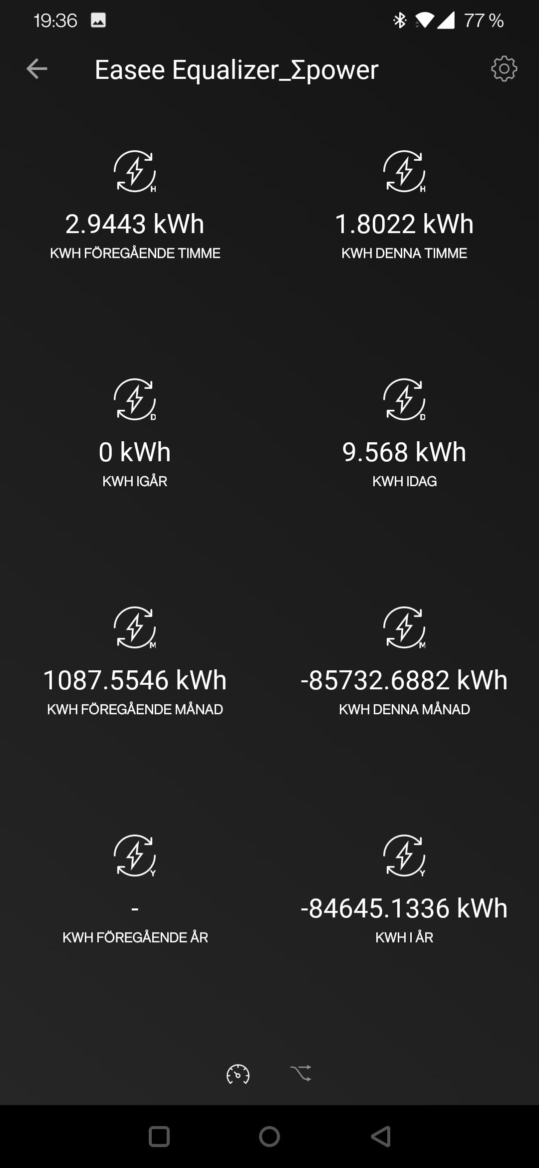

Did som restarts of Homey and suddenly it show - value on this month and year… the lifetime power value of the energy device is correct. So must be something is off in Power By the Hour app when I restarted Homey… any clue what and why and how to fix it?
also right after homey reboot? are you sure it doesnt get a faulty value even for a brief period?
Iv rebooted the Homey a few times this evening without anything helping. It been this fault since first reboot. You can see total kW drop allt at two times today…

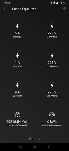

This is how it look now… still negative value but source energy is as it should be 29k kWh
yes, but can you share the same kWh graph for the source device (Easee)? Does that show a drop in kWh value after Homey reboot?
