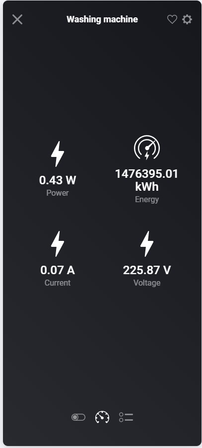

I like this app very much. But I have one Power summarizer that doesn’t update. I have a dryer and a washing machine, each on a TP links smart plug. Added each smart plug as Power summarizer to PBTH. The dryer summarizer is updating fine but the one for the washing machine doesn’t do anything. I removed it a few times already and re-added it but without succes. All setting are the same. Any thought what can cause this??
Cheers,
Wim
Do you have screenshots of both kWh states in the TP links app and in PBTH? Did you maybe enable ‘use watts as source’ for one device but not the other?
Hi Robin,
no, I did not have ‘use watt as source’ checked in either of them.
My wife just finished and I do not have a kWh reading from the TP Link app. I add a few screenshots below.
Below are two graphes. The pink one is the TP link switch in Homey Energy, the blue one is the PBTH.
Next you will see the two device pages. The first two are of the dryer, the next two are for the washing machine.
The washing machine has just finished so the value is very low.
I just checked the settings and they are the same on both PBTH devices. (except for the fields that are filled automatic.
the kWh value of the washing machine is absurd high. That cannot be true I hope for you! PBTH uses the differences in kWh value for its calculations (unless you select ‘use watt as source’). I suspect you have a problem with the washing machine kWh meter value of the TP link device. Try to solve that. As secondary solution you could enable ’ use watts as source’ .
Okay Robin, I will first check what’s going on with the TP Link socket. I was wondering why that was so high too!
Thanks sofar! I’ll keep you informed.
