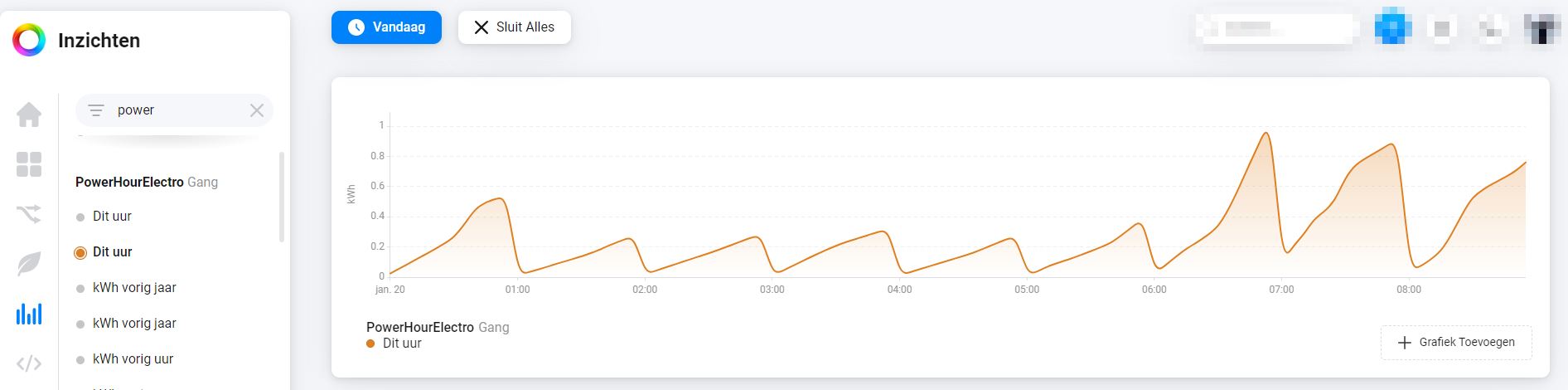

I did the update but my values are not correct anymore.
Hourly data keeps staying the same as Daily data
Data is also not correct, It seems like double the value.
Or maybe something with timezones, no idea

I think I am seeing the same as you. Sometimes the new hour event seems to be missed. So the new api introduces new timing issues :unamused:
I am doing some tests now. But I have to wait an hour every time I want to do a new test to see the result
 So this might take some time to fix. In the mean time all test users are better off reverting to the stable version.

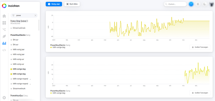

I noticed something strange today. After using ExportInsights also by @Gruijter . I noticed that my historical data suddenly showed the same value for every day since 1-11. While the current values are correct. No idea what is going on.
Using stable version 3.2.0
What happened on 1-11? Did you get a new Homey firmware maybe? MMh
 1 November is around the time I released version 3.0.0 (the rewrite to SDK3).
Ah wait. You selected the wrong ‘last day’. Since publishing v3.0.0 the Insights are stored in a different variable to enable showing the value in the device tile.

Actually I suspect that devices that often update the meter (like the main power meter) act fine. But devices that update only a few times or less per hour show incorrect hourly values. I have to conduct more diagnostics but I think I found a problem with Athoms new homey-api.
Hi @Gruijter
Your comment [quote=“Gruijter, post:412, topic:20535”]
[/quote] gave me enough ‘insight’ to figure out what is going on.
I can confirm there is an issue with the new API. It does not behave like the previous one. I contacted Athom to find a solution (either they ‘fix’ the new API, or I have to somehow find a workaround). So in the mean time: If you are using the test version of the app (3.3.0) you can expect the This Hour values to be incorrect sometimes.
