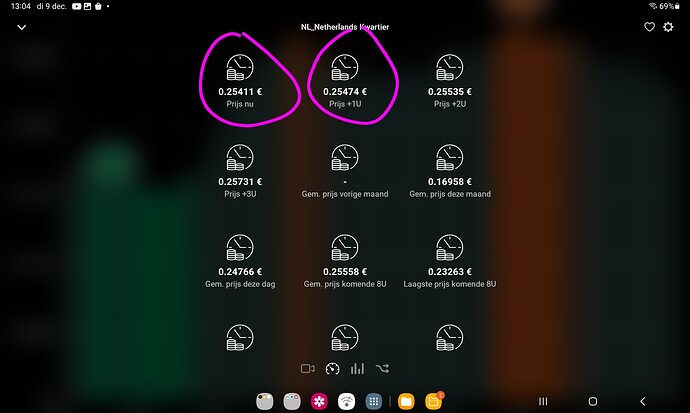

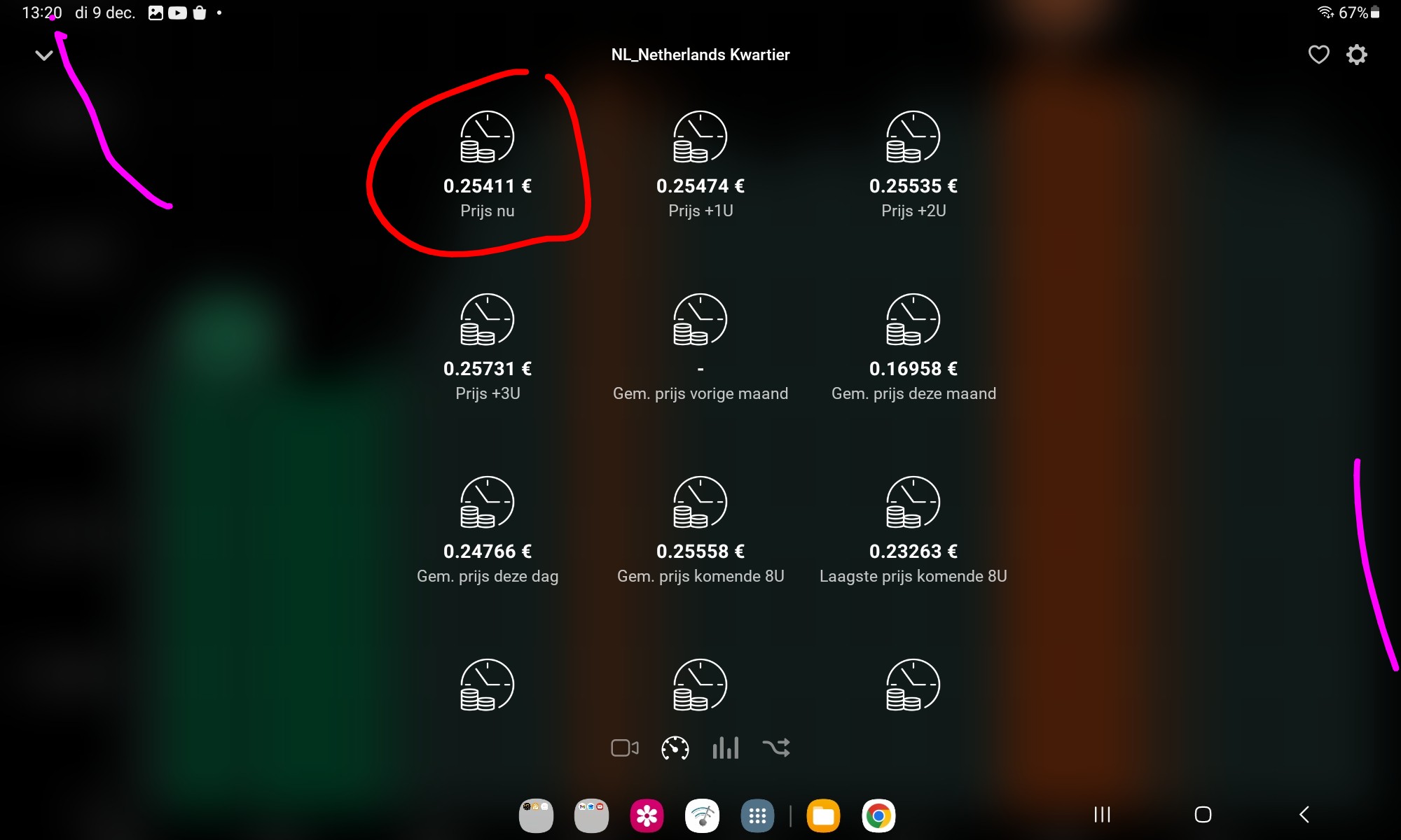

I use NL_Netherlands, but i think that the price in the second quarter of the hour is not correct. The price is the same as the first quarter.
Homey version: 1290
PBTH: V7.04
