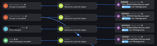

I notice that the “price change trigger” for the new 15m device is not triggered every 15 min. When doing my logging it does it on every whole hour, sometimes on the xx:30 and xx:45 mark.
Also on the whole hour this card is triggered 2 times.
I could not make on your latest changelog if this is something you notices as well and already fixed with “Fixed priceNow”

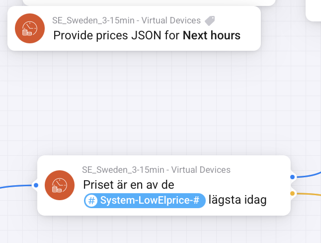

I might be the dumb here, OR I found a bug. Details:
15min Sweden SE3 device, all coming prices as json:
with the card I try to find the 4 cheapest prices, but it says it isn’t any of the 4 cheapest, if I sort by price I get that 13:00-13:15, 13:15-13:30, 14:00-14:15 and 14:15-14:30 is the chepest.
”System-LowElprice-#” has the value of 4 at this “test”.

Is only triggered on a price CHANGE😉. Try using the trigger: new price period. That triggers on every new price period, even when the price stays the same.
Flow cards are still work in progress.
Ah yes, sorry😴. I didnt push it to the app store. It is now!

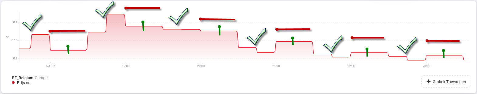

But I think there are some bugs in 7.03
It seems to me that only PriceChange triggers every 15 minutes, PricePeriod only triggers on the full hour.
In this example, the first log triggers every 15 minutes and the second and third only triggers on the hour.
