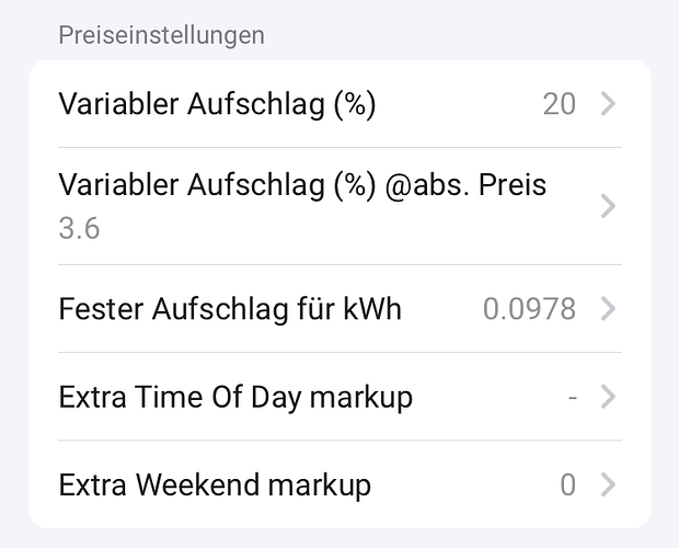

Since exactly midnight the app stopped using any offsets/markups and just returns the raw EPEX prices.
Restarting the app didn’t help. Trying to change the app settings results in a time out. Rest of homey works fine.

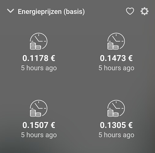

Also have some weird data, only some of my prices are filled:
@Gruijter created a diagnostic report if that helps you 16e73ca0-6470-4125-bddf-adde26031fdd

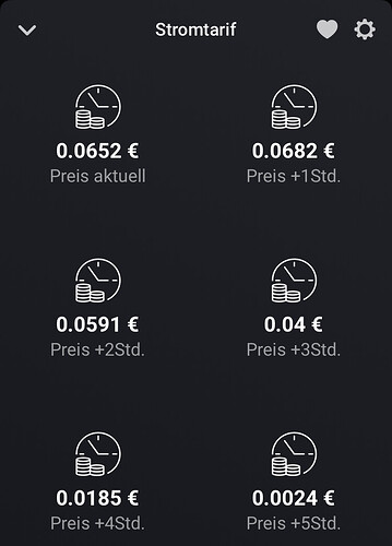

Further no images and wrong prices.

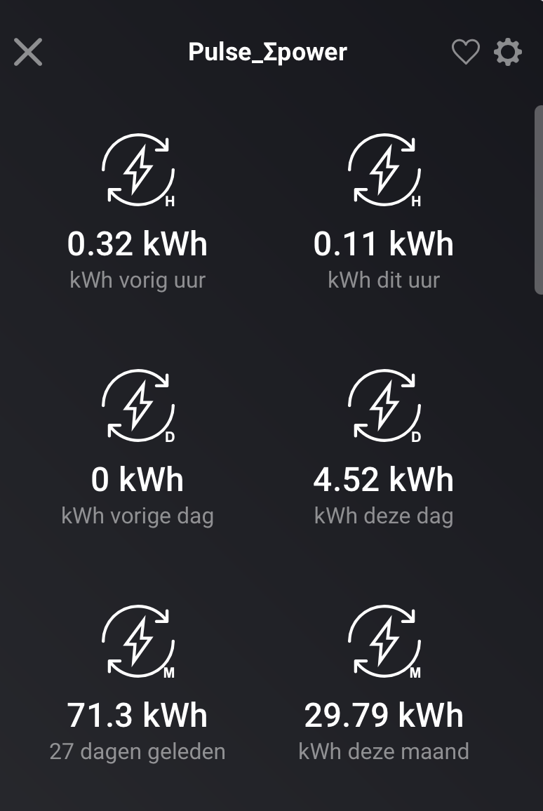

I have (for a while now) no more previous day usage (kWh vorige dag). It remains 0 kWh.
I have removed the PBTH device and readded it for the Tibber pulse P1 meter, but same results.
What can be the reason for this behavior?
Anything I can do to get this working?
