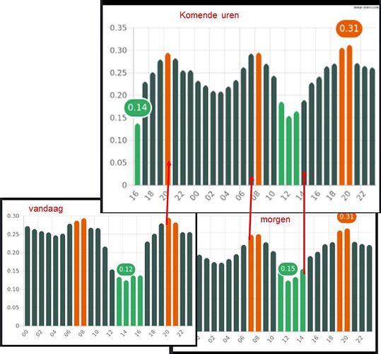

@Gruijter The color between the views today/tomorrow/upcoming hours is different.
is this a bug?
(search on color in this topic does not have any results)
today: 21:00 = orange, upcoming hours its black
tomorrow: 07:00 is orange, upcoming hours its black
tomorrow: 14:00 is green, upcoming hours its black
No bug. It just takes the lowest and highest 4 hours in the entire range. It is just intended as a visual aid to see where the lowest/highest prices are. Nothing more…
Ah OK, unrelated to the trigger cards.
Thanks

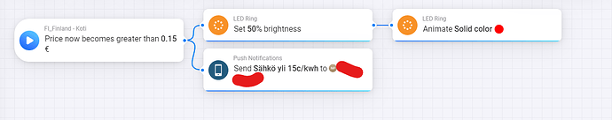

I’m trying to createa advanced to to use Price now trigger but for some reason I just cant get it to work. Here my testing flow, any ideas what is wrong. Nothing happens.
As you don’t mention for how long you’ve waited, and if the price got < 0.15 in the meantime:
Do realize the flow will only trigger if the price was below 0.15 first.
Now the flow has been active from the yesterday and the price has been lower in some hours but the flow hasn’t started. Tried also higher card with low € settings but no luck eather.

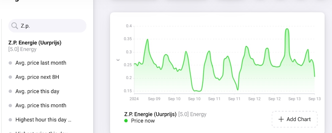

Can you show me the “price now” insights of this week?
It’s possible the price didn’t got updated.
Example:
This is todays chart. As seen it has been lower than 0,15
Here’s the week
