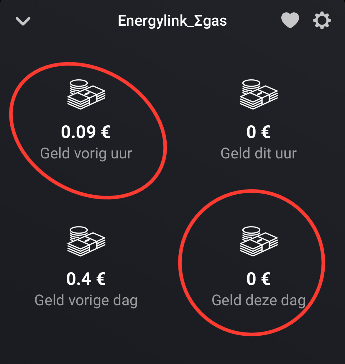

The other issue I is that the usage and price this day are going to 0.
See the screenshots.
They will mostly show a short time after gas usage, and after e certain time it’s 0.
How can I solve this?

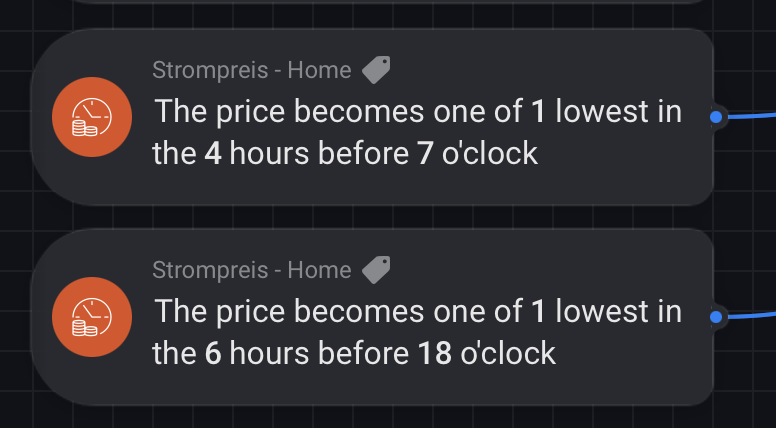

Has anyone else noticed that some of the WHEN cards are triggering too late? For example I have a flow which starts the water heating when the price is the lowest in the morning or the afternoon and I also add a timeline entry.
But for a few days now from the timeline entries it seems that the flows run with a pretty huge delay. It was for a few days 28 minutes, now it’s up to 39 minutes.

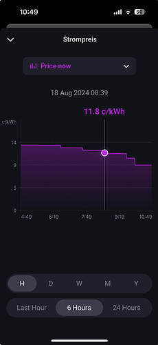

Also the insights are delayed by the same amount
I have tried to restart the app, which helps for a some time but then the delay starts adding up again.
After looking at the code setInterval is known for having the tendency to drift because of the event driven nature of JS. The time you specify is just the minimum time it will wait between runs. But usually it should only drift by maybe 10-20ms which will add up to a few seconds or maybe 1-2 minutes for very long running apps (which homey apps could be considered as).
My best guess why it’s so bad for me is that maybe because I have been using Homey for development last week that every app run interrupted the timers of other apps by a few seconds and worsened the drift.
I would maybe still suggest to change the setInterval to setTimeout and adjust the time after every run (kind of like you do for the first calculation).
