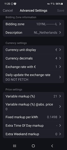

Try a different gas market as source: TTF EOD . I believe that is what ANWB is using.
Strange. I don’t have that under advanced settings?
As @Gruijter already mentioned, it’s possible to add fixed costs per kWh in the DAP (Day-Ahead) device. Your screenshot shows the Power Summarizer device.
Detailed information about the two different devices can be found in the 1st post of this topic.
Thinks. Didn’t understand that
If you want to keep using the prices from your Tibber app, you could add extra costs in a flow before sending it to the PBTH summarizer.
But using the PBTH prices gives you many extra features you will miss when using the prices from the Tibber app.
