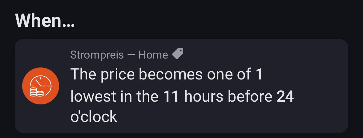

I think you just need to play around with some of the other WHEN cards, for example this would run for the cheapest price between 13:00-24:00

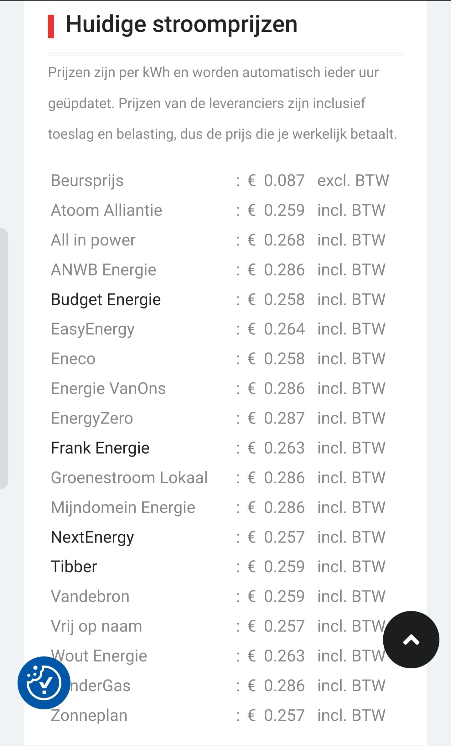

In case you didn’t know already, maybe interesting:
Enever.nl shows hourly prices of a bunch (or all) Dutch dynamic energy providers at once:
This is also available as daily feed, and it returns all 24 hourly prices:
https://enever.nl/api/stroomprijs_vandaag.php?token=Your_Token
A personal token can be obtained at enever.nl/prijzenfeeds/

Either “The price becomes one of <1> lowest of today” or “Price now becomes less than <0> c/kWh”

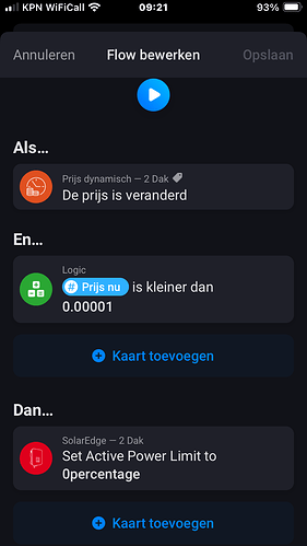

This flow worked yesterday:
Only 0 did not work :fearful:
Mmh. Maybe SolarEdge doesnt take 0.
Maybe because the price was exactly 0? You could try changing the equation to “less than or equal to” 0
