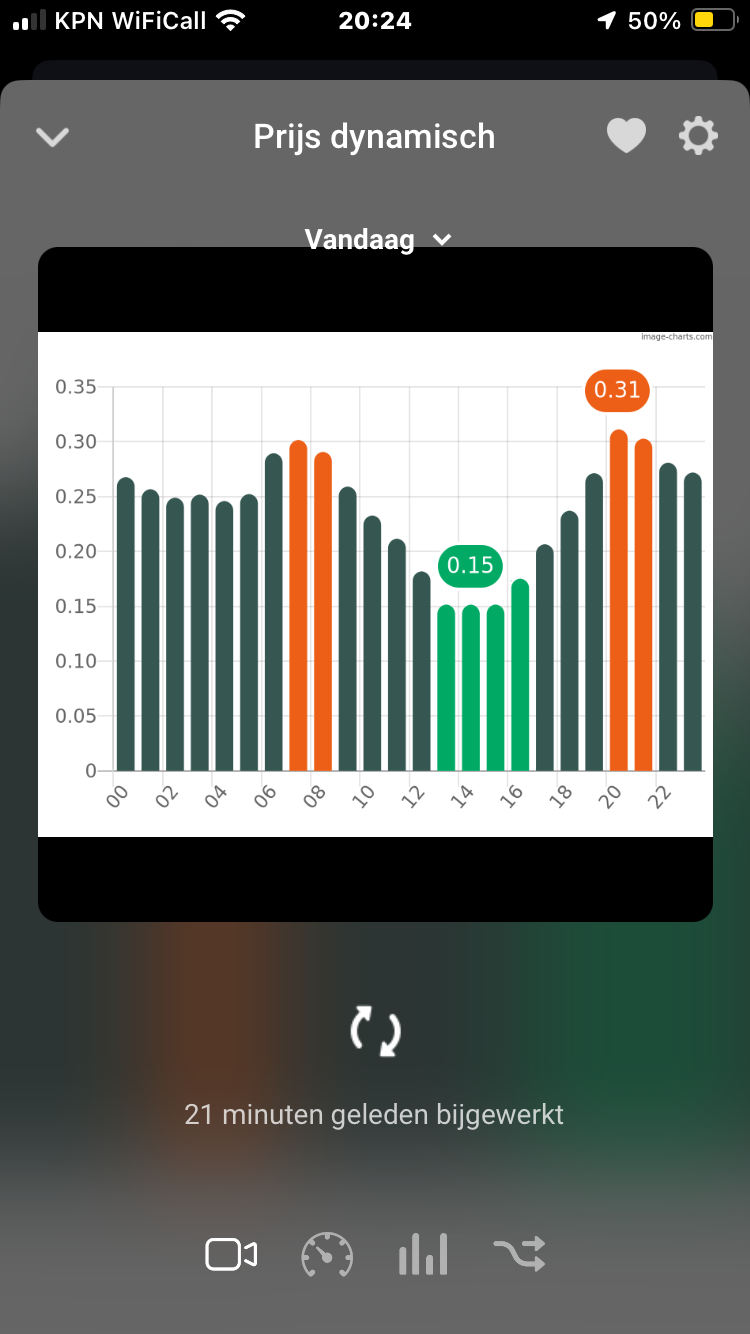

Between 13 and 15 €0.046 and not around €0.25.
I see that the price is not correct when the price is below 0.
The price is now -0.12 euro. I increse it with 21% and 0.18 euro extra cost. Then it has to be around 5 cent’s. PBTH syas the price is 27 cents at this moment.

Tomorrow the price is 0 and then the price in PBTH is correct. Sow it looks that PBTH icnore the minus price
No negative price today here in the app of Frank Energie.
Between 13:00 and 15:00 €0.046 all in.
By 21% and €0.15705 costs.
Edit 1
No €0.00 here in the app of Frank Energie for tomorrow.
Lowest: 13:00 - 16:00 €0.157 all in.
Edit 2
From PBTH JSON file tomorrow “13”:0.1571,“14”:0.157,“15”:0.1571, :+1:
I use “mijndomein” (now hegg energy)
The netto price is now -11 cents. When i increase that with 21% btw and 0.18 euro extra costs the price whil be around 8 cents all in
EDIT, at Tibber the all in price is now less then 5 cents and not 27 cent’s so something is incorrect i think
