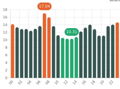

Zonneplan app:
Quite a difference, which one is correct?
PBTH is :wink:. Are you checking the same day? And including all taxes and costs?
Yes, prices for tomorrow in same chart as prices for today (which are correct). I checked other sources and PBTH looks right (sorry I doubted about that :grimacing:).

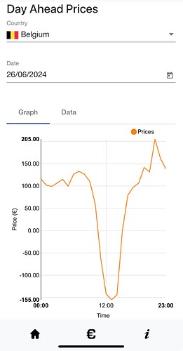

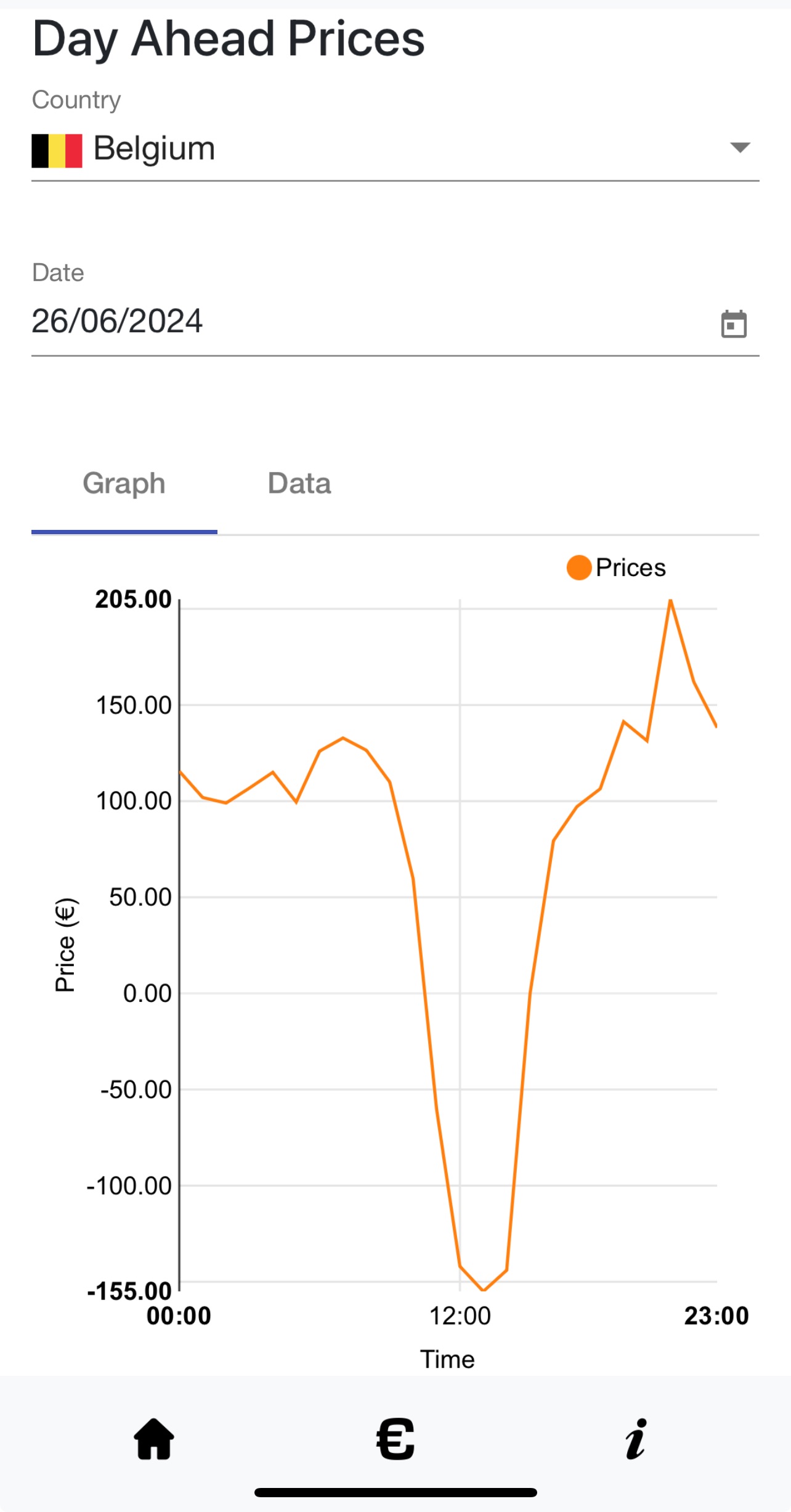

hourly prices for Belgium are also incorrect, I think Nordpool is wrong.
incorrect:
https://data.nordpoolgroup.com/auction/day-ahead/prices?deliveryDate=2024-06-26&currency=EUR&aggregation=Hourly&deliveryAreas=BE
Correct:
https://www.epexspot.com/en/market-data?market_area=BE&auction=MRC&trading_date=2024-06-25&delivery_date=2024-06-26&underlying_year=&modality=Auction&sub_modality=DayAhead&technology=&data_mode=table&period=&production_period=

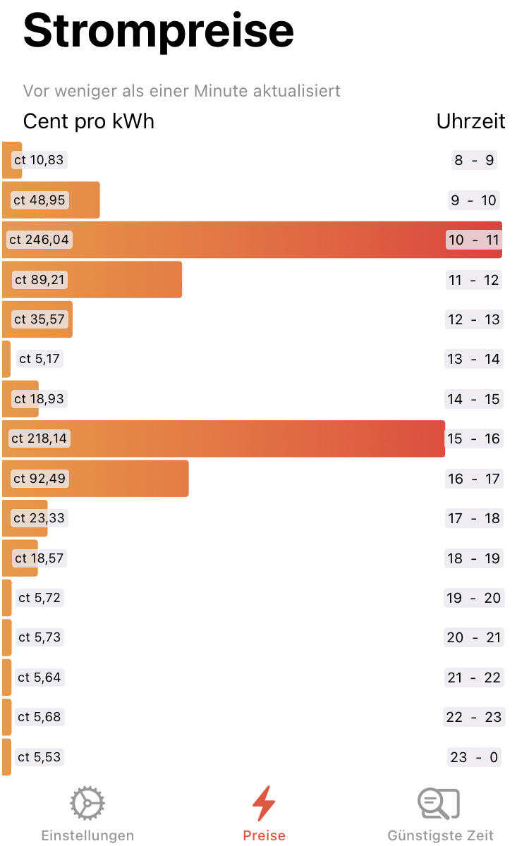

Prices should look like this (this iOS app updates whenever it is opened; it showed the same incorrect prices like PbtH until about an hour ago)

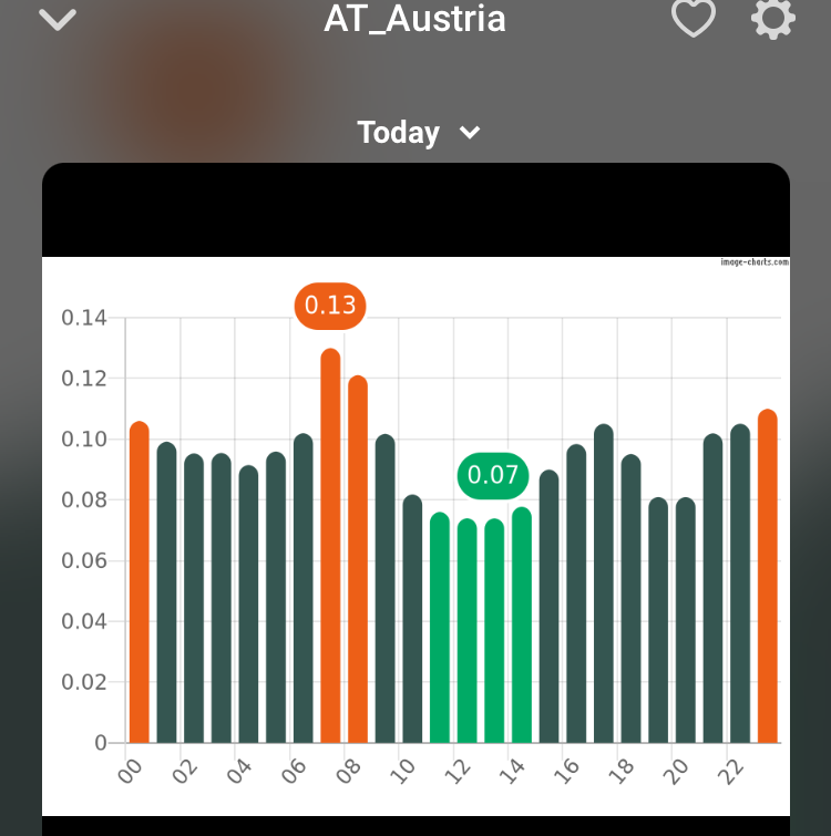

As I wrote - this are the actual prices for AWATTar for today (excluding taxes and fees):
And this shows PtbH (including taxes and fees):
And for direct comparison, the (incorrect) Austrian prices without taxes and fees:
I setup a new PbtH device without any offsets for the latter.
Those are my PBTH prices shown in Austria (in cents including some base fees for SmartENERGY). So for me it seems to be correct. But I think when I woke up and read the news it also was showing me the “wrong” values.
Funnily enough my energy provider SmartENERGY was still showing the old prices a few minutes ago and now their online portal is in “maintenance mode”…

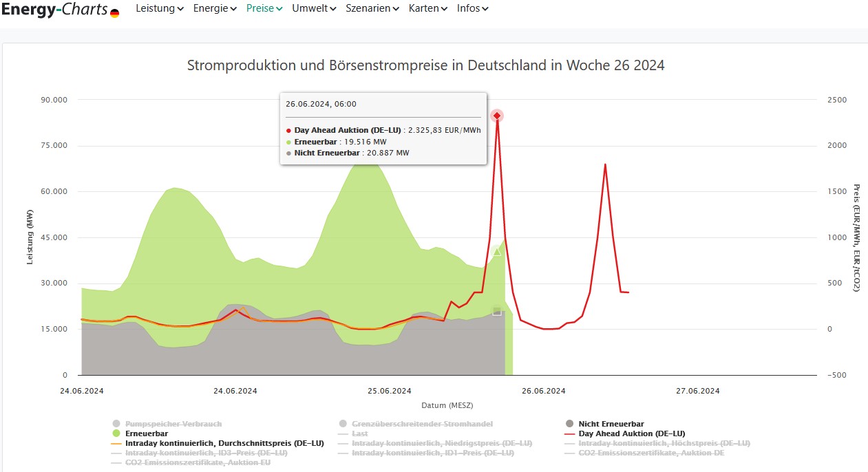

seems to be a similar issue for German DE_LU prices.
while the prices on epex have two significat peaks.
I have no clue, if there is an issue at ENTSO or a misconception about the prices.
I understand that Tibber is based on EPEX prices and PTBH uses ENTSO. But I do not understand where the difference occurs as it worked fine within the hundredTh of a cent, whenever I checked.

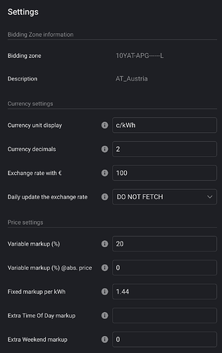

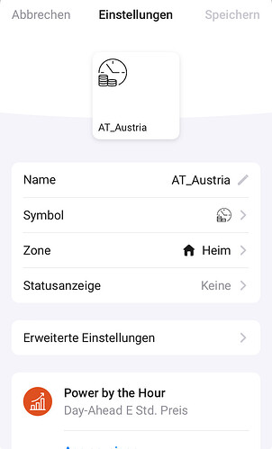

Can you show me your settings? I added a fresh device for Austria. These are my settings:
In an email from AWATTar they also mention incorrect prices on ENTSOE:
Those are my settings
