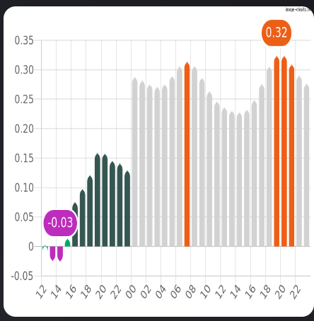

Hey. Excellent app. Wondering if it’s possible to push a picture of lets say cheapest 4 hours in the next 8 or something similar? Was thinking of using this to predict when car should be charging.
There is a flowcard with the data as JSON. Also if you figure out the http address of the images, you can push that.
Aah sweet I didnt see that flowcard. Gonna play around with that. Thanks :grin:.

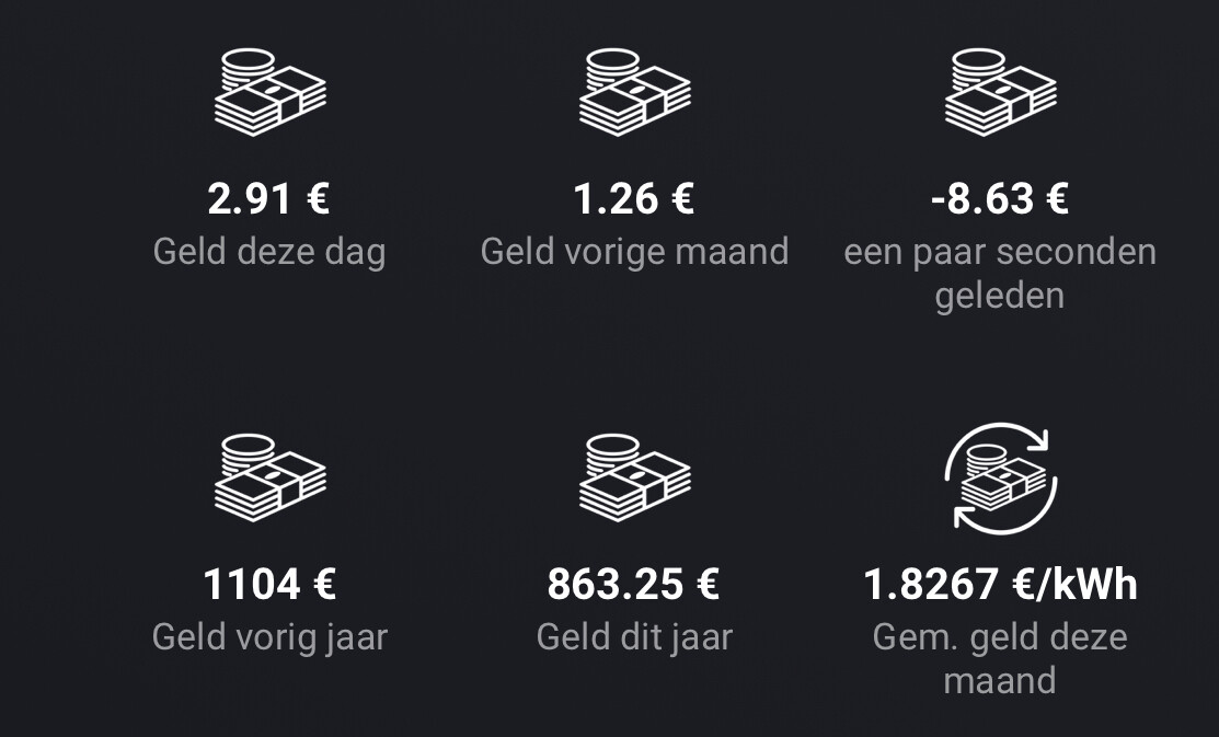

I have never noticed it before but it seems that in a summariser it goes wrong when there are two negatives.
At this moment in this month, I have -4,71 kWh consumption and -8,63 euro as costs.
The average for this month is calculated at 1,8267 euro/kWh.
I think this average should also be a negative amount instead of a positive amount, is this something I can adjust somewhere in the summariser or in PBTH?
Mathmatically this is correct. The average price per kWh is in this example a positive number (correctly). But because you delivered back to the grid the total ‘cost’ is a negative number.
(Why) is it an issue for you that the calculation is working the way it is done now?
Thx for the reply.
It is not an issue for me, it seemed strange to see it this way and I thought it should be a negative number.
So I thought to mention it so it could be corrected but as I understand now it is already correct.

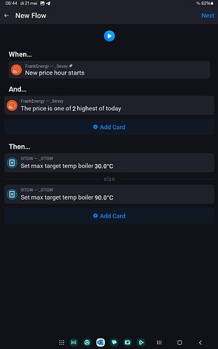

I have tried to add a flow to automatically reduce heating systems target temperature during the two most expensive hours of the day. What trigger shoud I use so that the app would always find the expensive hours (no matter what the price) and reduce temperature during those hours?
