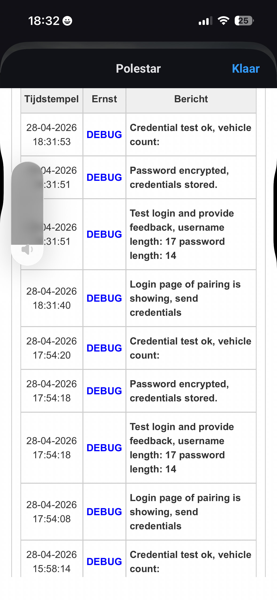

“Credential test ok”, so not a credentials issue.

Ok, now I have a ‘your login was succcesful, but no vehicle were returned’. When I check with the same credentials on polestar website, i see the car and i am the owner. Polestar app works.
Any Idea?

The root of the problem, api said 0 vehicles, is something I can not truly debug.
