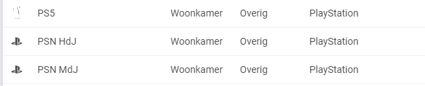

Okay, I didn’t create a PSN device for him to. Now I did. I have created this flow for testing, but it doesn’t start
I have devices:
For device PSN MdJ i created the flow:
And it works :slight_smile:
Okay that’s clear. But it is not specific for 1 user and that is what I want, if it is possible.
It is for one user. The user who is mentioned in the device PSN MdJ.
In the meantime I also tested a version of your flow and I got it to work. But is is case sensitive. In my flow I used K but my account starts with k. So after correcting my version of your flow also works.
I guess you gave me the solution. Thank you for your help Hielke and have a nice weekend!
