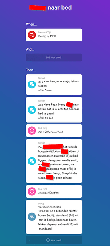

Hi, is it possible this great tool does not work in a flow with more actions? If the only action is presenting the pipup it works great. Thx!
Can u share that flow plz? Should work both ways ofc.

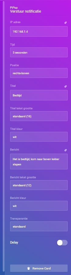

Hi, this is the flow.
It tels my daughter to go to bed.
I have test again but it does not pipup.
Thx!
Ok. And what happens when u hit the test button?
the test button in the flow manager, nothing.
The flow runs behalf the the pipup.
a testbutton in the pipup app would aslo be a good idea
hee, when i open the pipum app in the TV again ik works
i seems that it does not work anymore afther the tv was shut down
