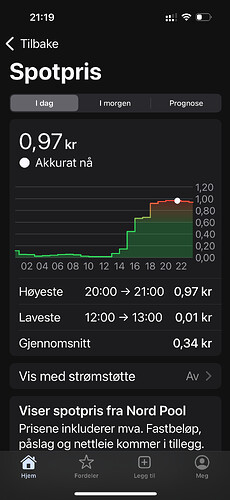

Noe rart med strømprisen i appen?
Scroll up to post made by me July 2
Great. That fix it. Thank’s

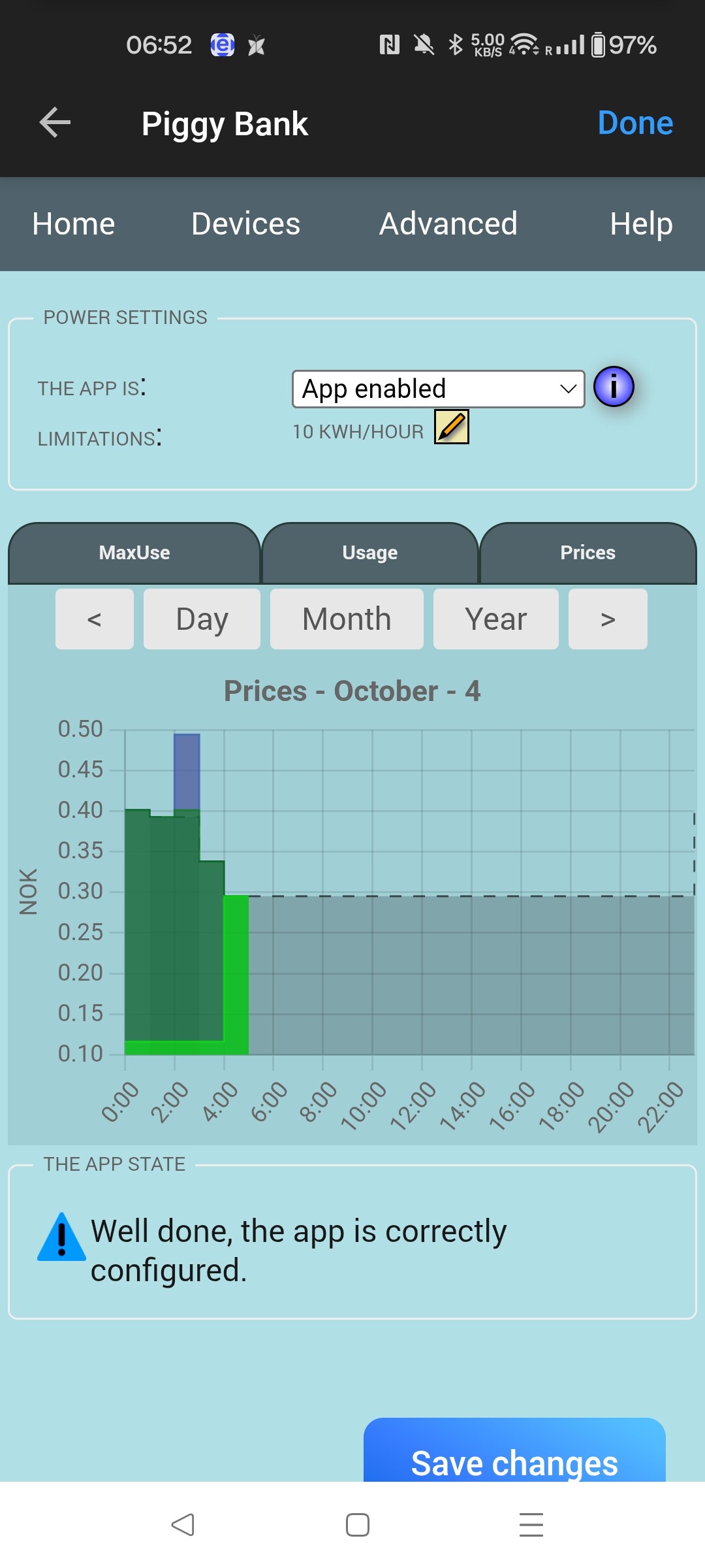

I also see some problems in the price chart. I have set the prices in “Norwegian electricity app” and set external in piggy bank. But Piggy bank shows a weird price chart. Does anyone have the same problem ? Any solutions are highly appreciated :slightly_smiling_face:
Yes, same problem here. Seems like this app doesn’t handle the new format from NordPool (15-min price chart). I am instead using PBTH-app for calculating energy-prices, and then using flows to set the correct price-leve (normal,cheap, expensive, etc) in Piggy Bank app. For me this is at better solution, since I then also can include the different levels of grid prices in the calculation.

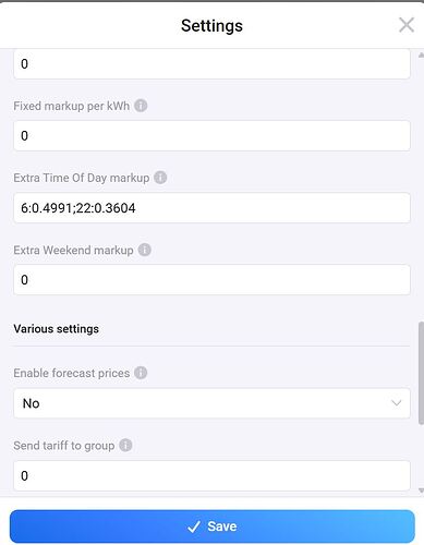

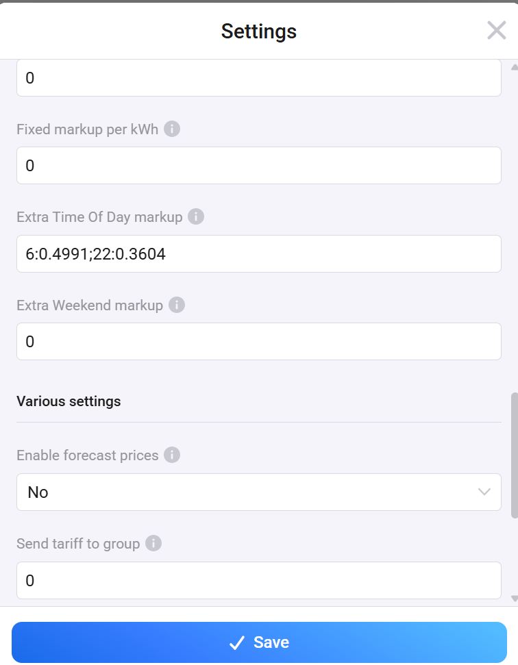

Thanks! Do you also get the time-varying grid prices (06-22 and 22-06) via PBTH @Hallgeir_K and @Kaushal_Pander ?
After reading a bit it seems like it’s possible to do with the “Extra time of day markup” ( Feature request: fixed markup changes during day/night · Issue #33 · gruijter/com.gruijter.powerhour · GitHub ) - have you used this one? Not sure if it should be inputted in EUR or in the local currency, will have a try later today.

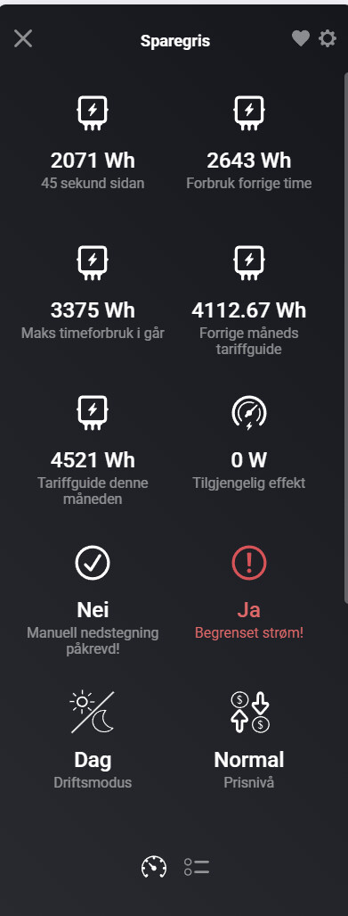

Hi! First, thanks for a great app — it reduced the need for flows a lot when I discovered it!
Lately I’ve noticed it has been struggling with the limiting of the power function. For reasons I don’t understand, it regularly reduces the “Available Power” to 0 even though the predicted usage is well below the target. I have tried a bunch of different options (smoothing = 300% and disabling daily and monthly caps). Here are some screenshots of the graphs and piggy bank tiles.
I can see that several users have experienced this at the beginning of every hour, but I experience it often at random times. I use Tibber Pulse for power monitoring, and I know this can cause issues at times, but Tibber seems to be working fine when the limiting occurs. Power of the Hour does not have the same issue with calculating the available power.
I can see that Frode is not that active anymore, but if any other user has experienced this and maybe has a solution, I would really appreciate some help.

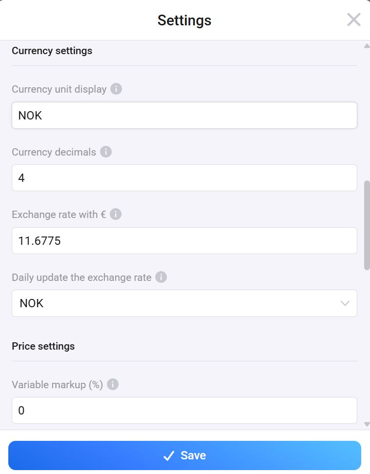

I observed that the latest test version v 7.0.3 of PBTH app works much better. Had to use exchange rate and the “Extra time of day markup” feature for the grid price to get accurate total electricity prices. screenshots attached

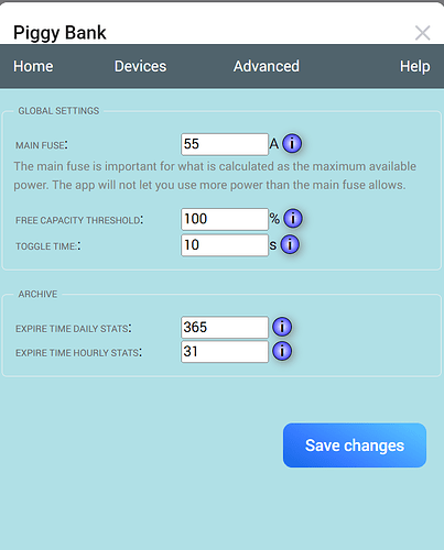

Hi, I am new to Piggy Bank app..so my interpretation might be wrong. In my experience the “available power” in your screenshot depends upon the settings of the fuse capacity as shown in the screenshot below
@Kaushal_Pander, thank you for the tip. It is set to 63 A, so i don’t think it’s the max power that is the issue. I was probably a little unclear, but the problem is that Piggy sets available power to 0 even when current load is at 0,5-3kW. If the load was high and the estimated consumption was stipulated to go over the 5kW per hour I would understand the need to start limiting. But it’s not that… Seems to me that there’s some bug or something else that I do not understand.
