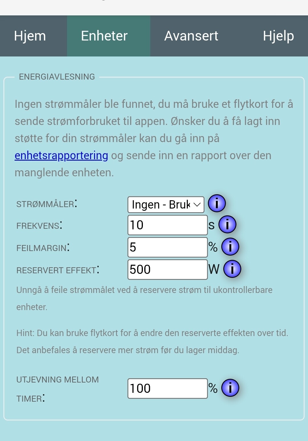

What value have you set for “reserved power” (reservert effekt) ?
