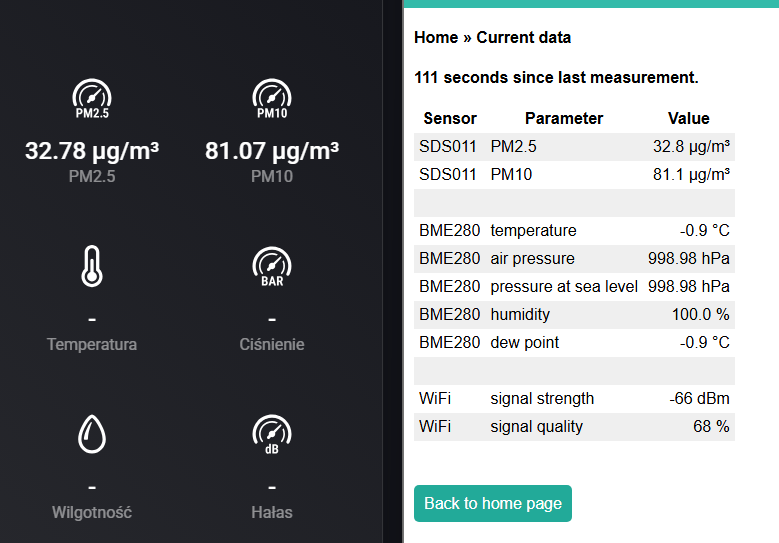

It’s my own station. Data is outdated from 5 days, and value changed during the day after I updated the app. When I taken the screenshot it was 0°C, but value stuck at -5.4°C:
I tried to restart Homey, remove device, and add it again, but still no luck:
same here, think there’s still a little bug since I only get updates of PM2.5/PM10.
urgency is off for me since I mainly use PM values for ventilation purposes, outdoor air quality can get pretty bad with wood (and other stuff) being burnt in stoves by neighbours
Also using my own Luftdaten device
Since some weeks the data remains stuck. I removed the app, installed it again, but was not able to add a new device. Now I am back from holidays, I have managed to install the app and to add a luftdaten device and my station was visible again. But as mentioned by others only the PM2.5 and PM10. All other parameters are still gone, also my recently installed noise sensor. I was happy that this one also was showing its data in the app.
I hope it will be restored some day.
I’m also using my own device data. Only PM2.5 and PM10 are correctly displayed in the Homey app. Temp, Pressure and Humidity are unchanged since the issues occurred with the Luftdaten server as this app fails with an error message when loading those parameters. Going to the maps.sensor.community all data is available and updated frequently again so I do hope the Homey app will fix their data retrieval issue soon.

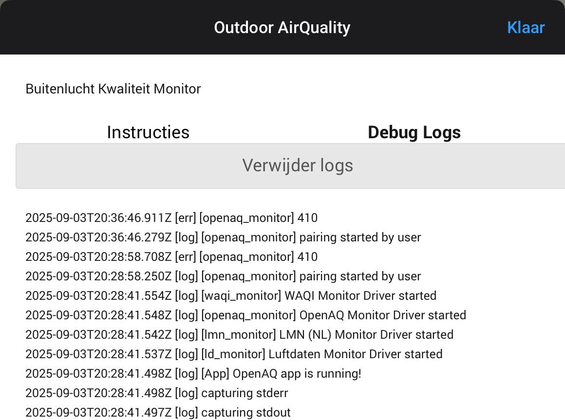

I am trying to add the OpenAQ device on my Homey Pro 2023, but get a 410-error during the pairing process:
The app log does not seem to include any clues as to what the cause may be:
Not sure what I am doing wrong. Does anyone have an idea on how to proceed?
