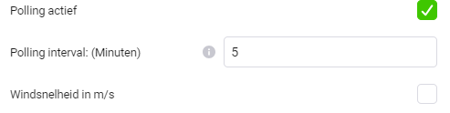

Wind speed ist set to km/h in device settings.
grafik
What device are you using? And which app version is installed?
Using the NO API device
Not set to m/s
I’m using 1.5.5
There’s hardly a breeze, but device says
Can you please check the API data with you lat/lon and API key?
Just to be sure, the API is reporting the same data your are “feeling” :slight_smile:
https://api.openweathermap.org/data/2.5/weather?lat={lat}&lon={lon}&appid={API key}
I think your device is using km/h as value, but somehow the unit is not changed. Can you please change the setting to m/s, then store, then uncheck the m/s setting. Then check if the capability unit is changed to km/h.
That did the trick! Thanks.

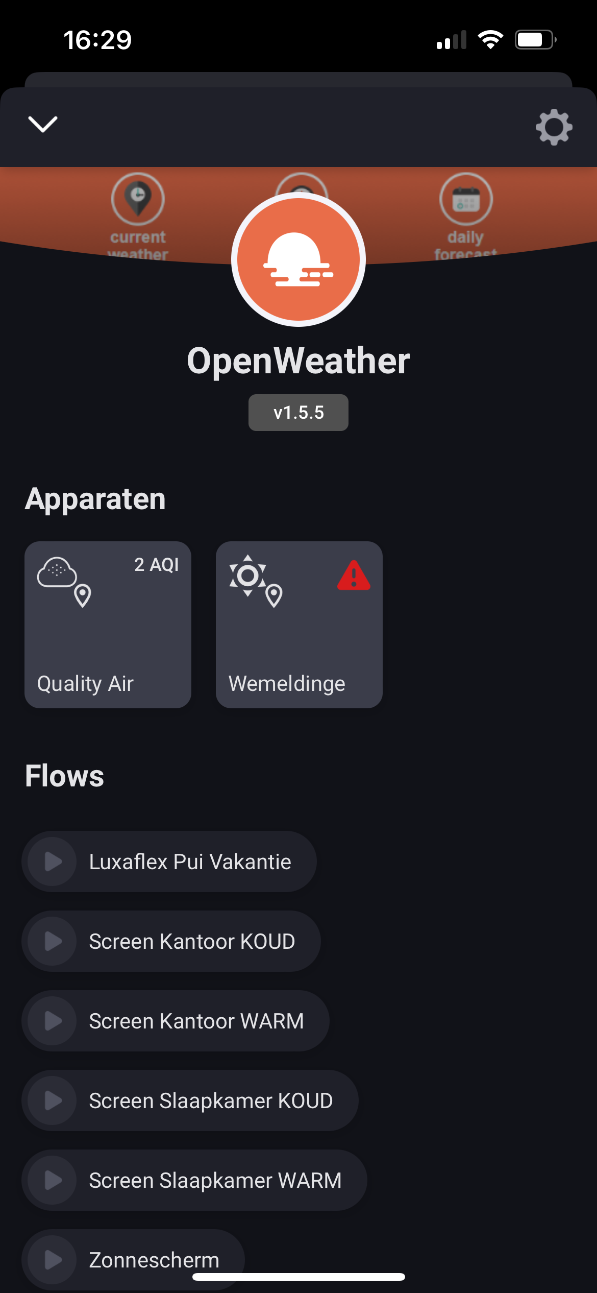

Yesterday I noticed that my 3 Open Weather devices no longer work, red exclamation mark.
I have not made any changes in the last 3 months. I also could not find an error when checking the device settings. A restart of the Homey app did not help either. Later I discovered the attached mail in my inbox. Can you explain to yourself how it can be that I seem to have suddenly exceeded the limit of 1000 views?
Ps: Since this morning, all devices have been working again.
Only the location devices (current weather) are using the API.
But you are right. 3 devices calling every 5min makes 864 calls a day. I think that was an issue at OWM itself.

Eeeeh it was the dev self who wrote the air quality was not working right ?
So now i am just saying the quality is working … but now i have the error with the weather
So i think he knows what i mean
But for YOU i have added the screenshot below
Restarted homey and the app …. But that does not help if an app server is down right ?
So i gave all the info i think … just that the same is now happening to the weather … but quality is working … not sure what to say more
Can you please check the message shown in device details? Thanks.
Hi ronnie
Was just typing the reply.
Invalid Api … probably to do with the upgrade from 2.5 to 3.0. The mail from open wearher in that ended ip in my spam folder … so was not aware
So they are deactivating all 2.5 API keys now? I know it was announced but wasn’t sure when they will proceed.
June 2024, acc. this info.
Thx. So they are a bit late :smile:
Perhaps the do it in phases … not sure if that is logical
Same mail like the other guy … but different date
Thank you Ronny, I was trying to get some info prior to my diag. from their pages, but “all was green” … seems to be fixed now on their side. :+1:
