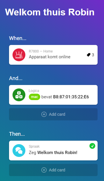

I am having issues with my flows for presence.
This flow is disabled after about 8 hours because it is executed too many times.
Is there something wrong with my way of thinking or is there something wrong with the App?
The flow looks ok. It will be triggered everytime a device goes offline. In the app logs you can check how often this happens, but in my home (with 25 devices, and around 10 wireless devices going offline every now and then) this only happens a few times per hour on average. I don’t see how Homey can think that ths flow is triggered too much, unless it would be triggered multiple times per second. And that is extremely unlikely. Is there no other flow that is causing this issue maybe?

2 example flows I am using myself. As stated before the flow you showed before looks fine to me and should not give any problems. You might want to try to fully delete the app, and reinstall. Maybe something went wrong in Homey during the install. But that is wild speculation… I heard similar problems for other flows (using other apps) so I do think there is a bug in Homey somewhere.

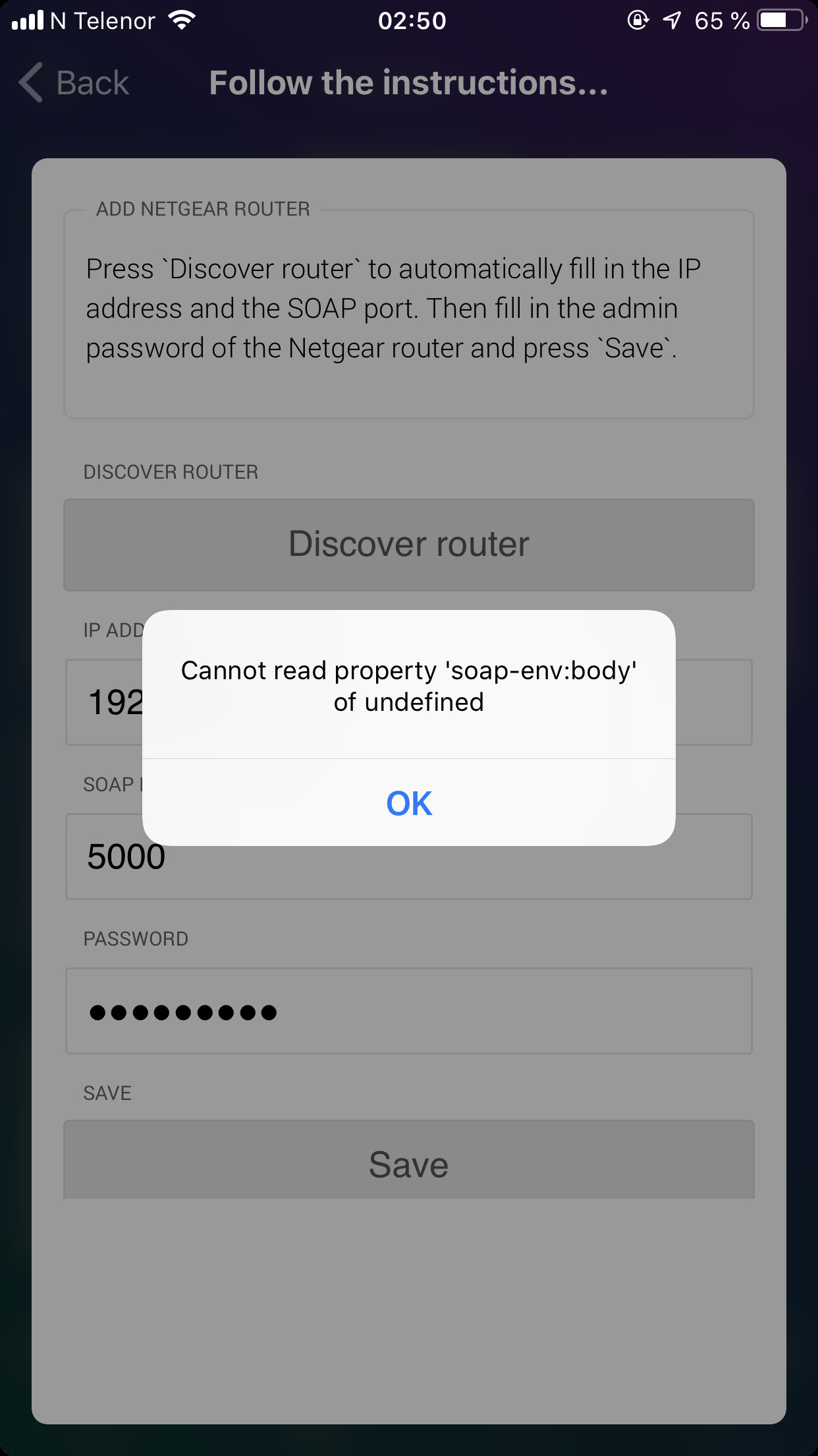

I recently got a R6020. I can’t connect it to my Homey. All I get is this error message:
Any advice? I have tried restarting router + Homey but with no luck.
Does your router work with the Netgear Nighthawk app correctly? Is the router on the latest firmware? If both yes, then please create a issue on my Homey Netgear app github page, and paste the result of the test there (this can be found in the Homey Netgear app setings tab)
Thank you for the quick response.
It works fine with Nighthawk app (and routerlogin.net) and it is running on the latest firmware. I have created an issue on GitHub now.
