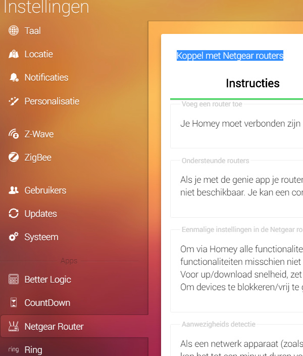

I was expecting the router to become visible in the settings screen based
on the ā€˜koppel met Netgear routers’ sentence below
After testing in the Test tab I thought you should add of find the added device in the Apparaten section
Of course it is all down the reading the instructions tab -> ā€˜Voeg een router toe via de Homey tab Apparaten en vul het admin wachtwoord in.’ Thought you meant the Apparaten tab under Settings (see screenprint above), but (of course :roll_eyes:) you meant the Apparaten - add new device - screen.
The rest of your instruction was clear, adjusted the settings on my router to see up-/downloadspeed etc.
Ah, ok! Thx for the feedback. I will definitely improve the instruction text.:+1:
