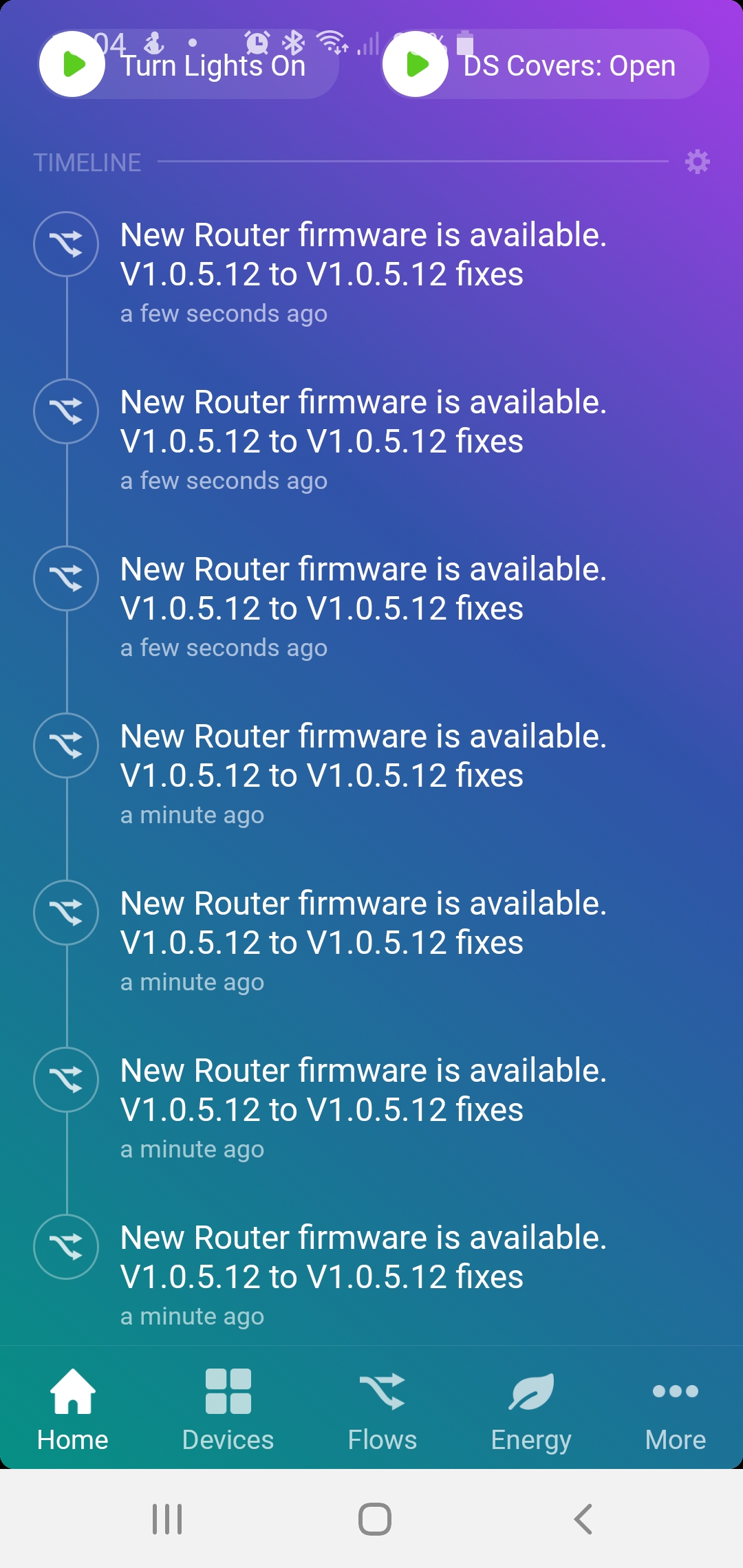

There is an issue with the ‘New router firmware available’ flow trigger. It keeps triggering every few seconds even though my firmware is up to date.
I have added a notification card to the Then section that shows the current, new and info tags and my timeline just fills up with notifications.
