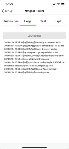

Ok, so I reinstalled the netgear app and tried to add the orbi. Everything is at its latest firmware. Deze are the errors I get:
Try to do the test a few times, with at least one minute wait inbetween. Sometimes Homey doesnt timeout…
Tried it many times, but no joy… :disappointed:
