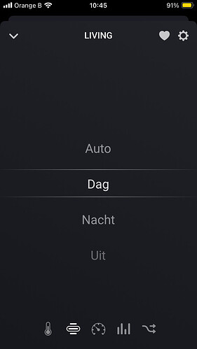

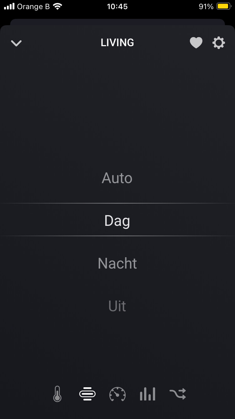

Just tested version 1.5.2, i cant set the heating mode anymore trough the device. Yesterday on version(v1.2.?) it worked. flowcard was available and didnt work either. When i do this the zone goes from orange to black, but after 3 secconds its back in orange. So o guess that its the same problem with the temperature and it wil be fixed with your version 1.6.

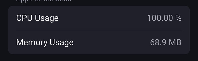

During the test I noticed following issue:
Must be some endless loop, memory usage is normal.
CPU should be every minute a small spike of 10% usage.
I this still happening? Could you send a homey diagogstic support (app > settings > make diagonstic report)

When i make changes in the homey on the device in temperature, the thermostat reacts after 10 secconds. When i change this screen it doesnt reacts.
I tried the flowcard to change the heatingmode, but i also get no reaction. Currently i solved this in the flow by using “set a temperature” , and “cancel temperature” with a delay of 10 secconds.

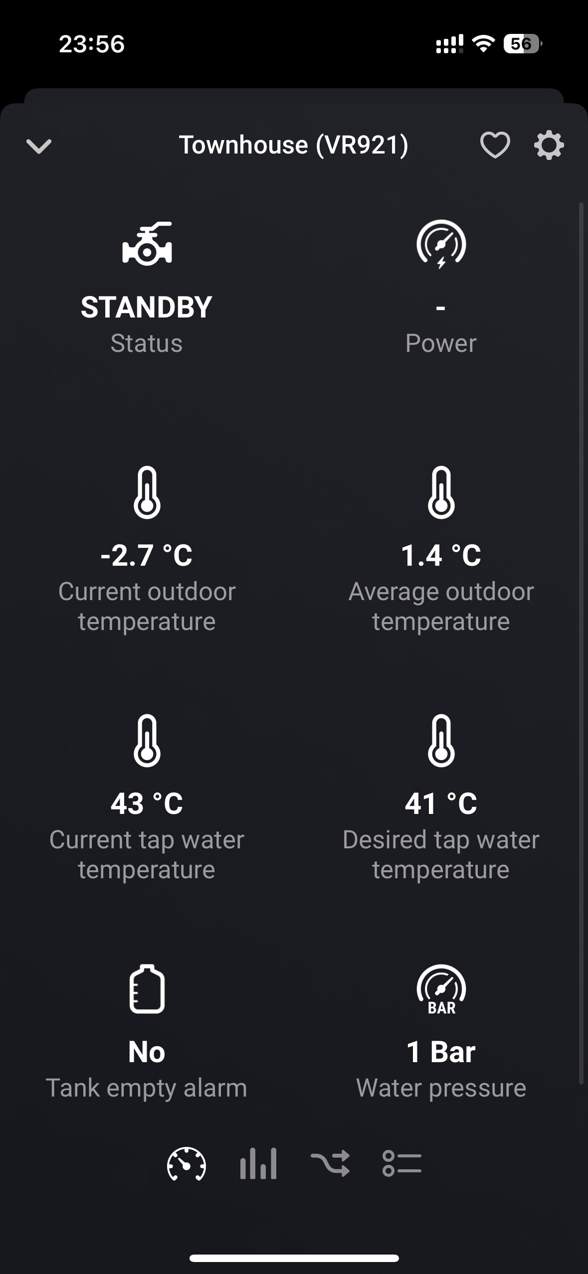

He, the outside temp is indeed part of the heat-pump. Will rename this to a more generic term, because I see it also works with other types of heating source than heat pumps.
But for now you could add you’re setup as a heatpump.
The domestic water options and water pressure are also available in the ‘heatpump’ device.
For domestic water it is not yet possible to set the mode, but setting a the temperature is possible

I have outside temp as part of VRC720 and Domestic water as well
I think this data should be available from API.
I am not using heat pump BTW, just a condenser gas boiler

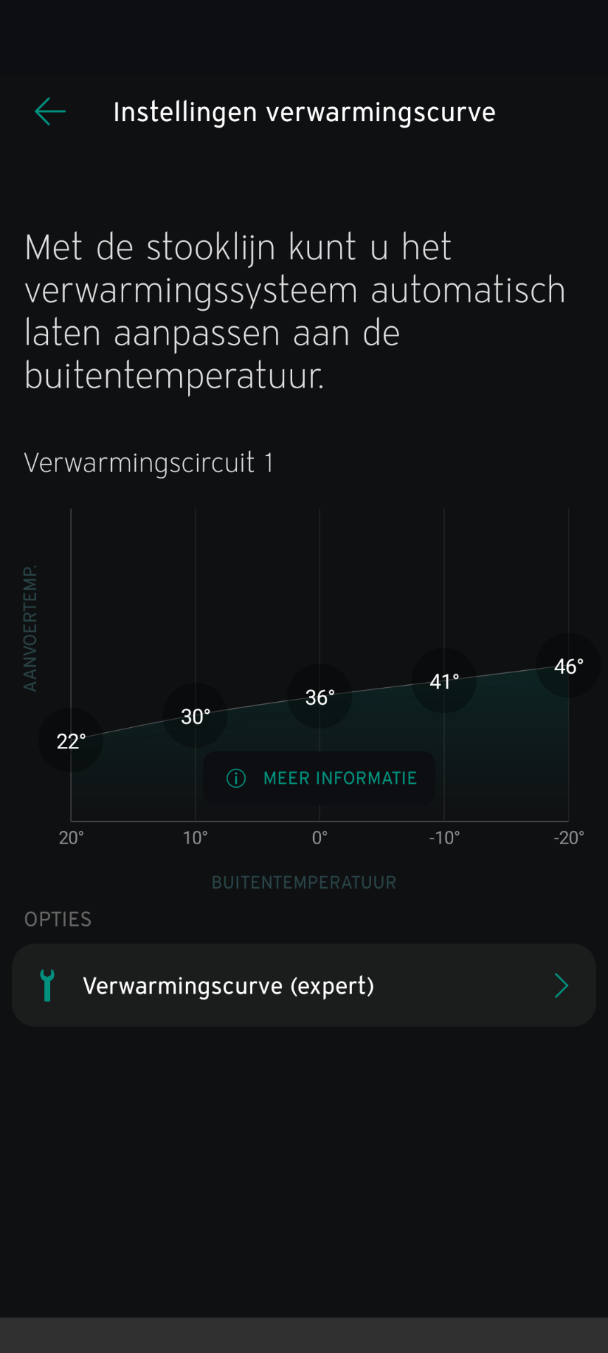

When I use the cart “Stel warm water in op…” the minimum setting is 35 degrees Celcius. Is this the “tapwater” or the “CV water” temperature? When it is CV water, why it is not possible to set below 35?
Of course the thing I like to create is a manual setup for the “stookcurve”
Of course the most convenient solution is to “set the outside temperature” and Vaillant just start to use the build in “stookcurve”
This is currently only possible trough flow actions cards.
