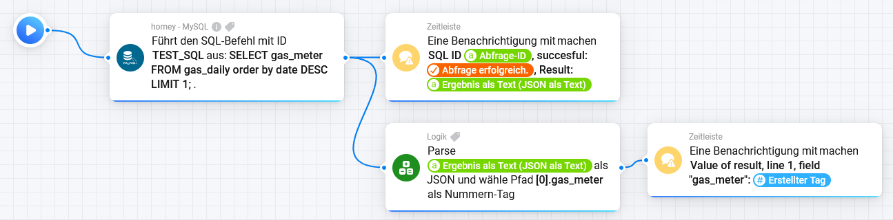

Sorry, I tried reading the FAQ but I still don’t get it. How do I use the output from a flow that makes a select from a table? I created the SELECT flow, it works, but the second flow cannot get the result from the first flow?
Thanks!
Are you using standard or advanced flow?
Advanced flow is much easier because you can concatinate the cards.
Thanks @RonnyW - It turned out that Homey was a bit crazy when I tried this. I works great today!
