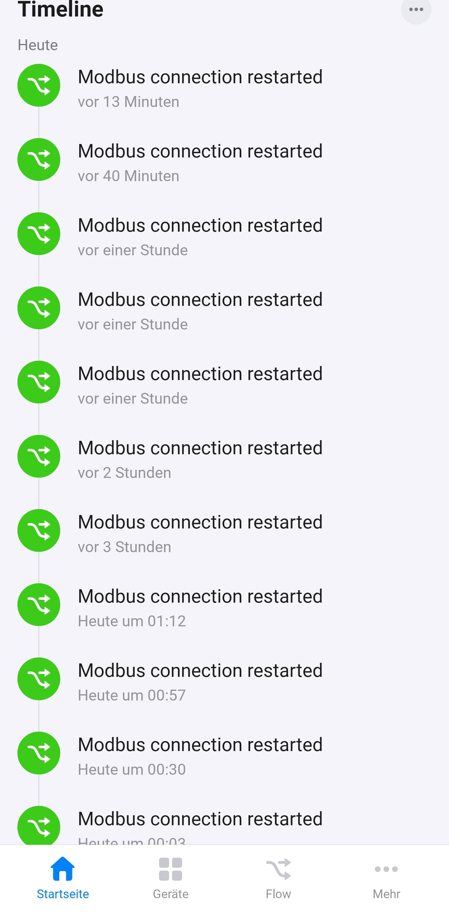

As mentioned, I set up a flow to restart the Modbus app when there is a error code coming with readout of a Modbus address. With this I get my data read. With the modus “Keep connection” the error code comes more often than in manual mode. As suggested from Ronny I put a timeline message on each restart of Modbus app:
@Bosse_Rasater in older versions the connection only worked if you connect directly and exclusive to one single ID. But connection to more than one ID didn’t work with my Huawei system. Also if it worked at all, it always stopped after two hours or earlier. Ronny doesn’t have problems with his own fronius inverter. This seems to be a Huawei specific problem. So thanks to him that he invested so much of his time to help us Huawei users to get along.
