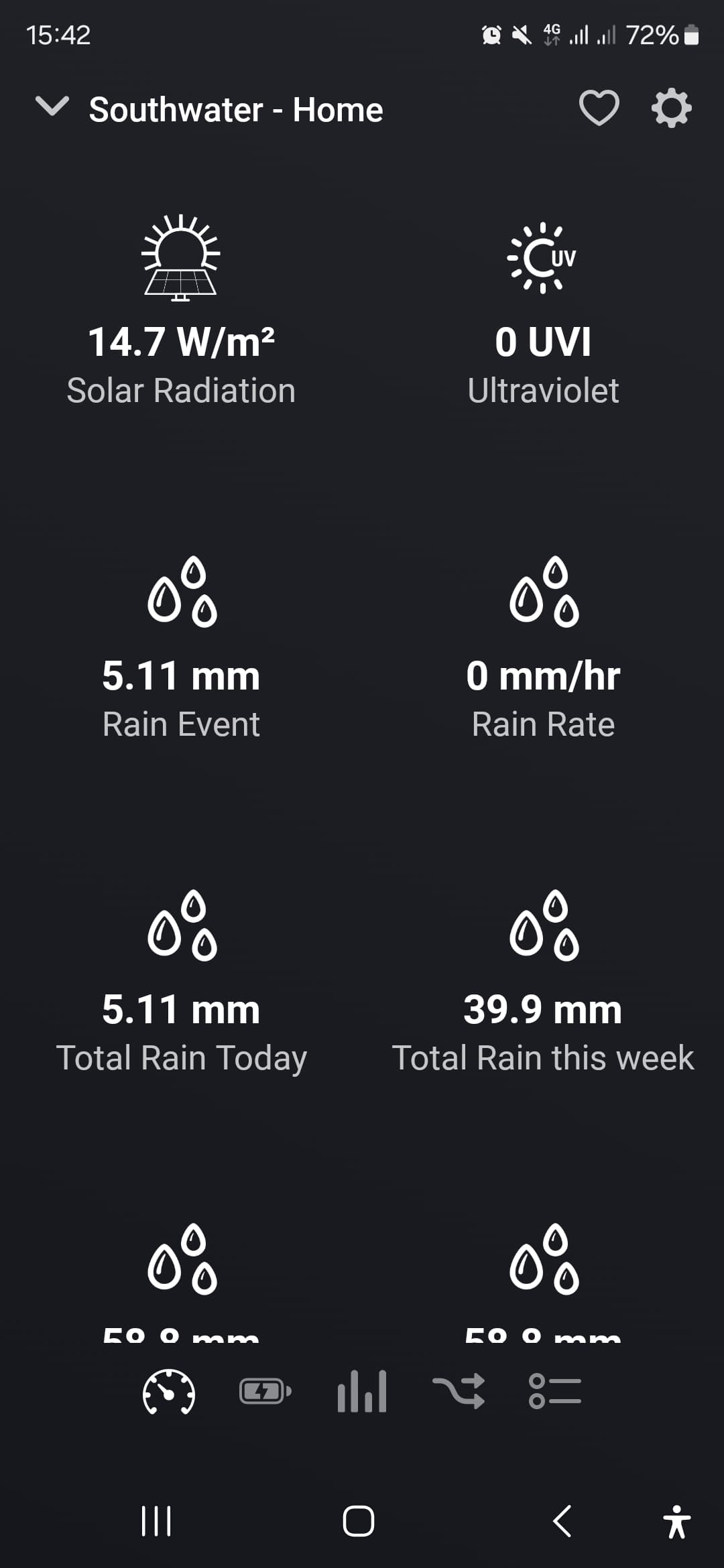

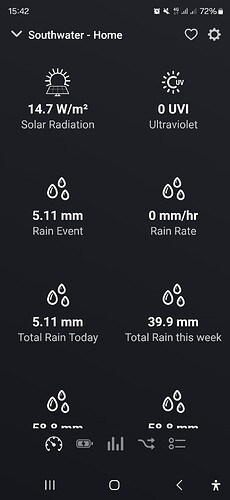

Decimals are not displayed on my rain sensor. But I can see it in the Ecowitt app. How do I fix it?

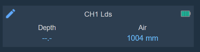

I have just received EcoWitt Laser Distance Meter (LDS01) will you add it to the app
I have just send the log to you from the Homey app…
There are 3 entries regarding the LDS01
“air_ch1”: “1004”,
“thi_ch1”: “0”,
“ldsbatt1”: “3.10”
If you need more info… let me know :slight_smile:
I see 2 decimals. I presume your region uses a , for the decimal point, so I wonder if that is causing an issue. Could you send me the Detected log from the app settings page.

I have published a new test version that will hopefully fix the number of decimals issue.
Hello!
It working! Thank you so very much.

I’m trying to work out what the battery value is. I see the unit take 8 x AA batteries so if they are in series that totals ~12v, so I’m guessing that not what is being measured. Maybe they have 4 sets in parallel of two 2 in series as that would give ~3v and if your batteries are brand new, 3.1v wouldn’t be unreasonable. So can you confirm that in any way?
Basically, Homey reports battery level as a percentage, so I need to work out an approximate conversion. For a single AA, I normally use batP = (batV - 0.9) / (1.7 - 0.9) * 100; which gives a fairly good indication.
Edit: I notice also the image above shows the distance in mm, but the specification shows it is has an accuracy of ±1.2 cm and a resolution of 0.01m, so a mm display is very misleading. Homeys built in distance capability is in m to 2 decimal places, which fits the spec, so I will just stick with that.
I have published a new test version that should support the Laser Distance Sensor.

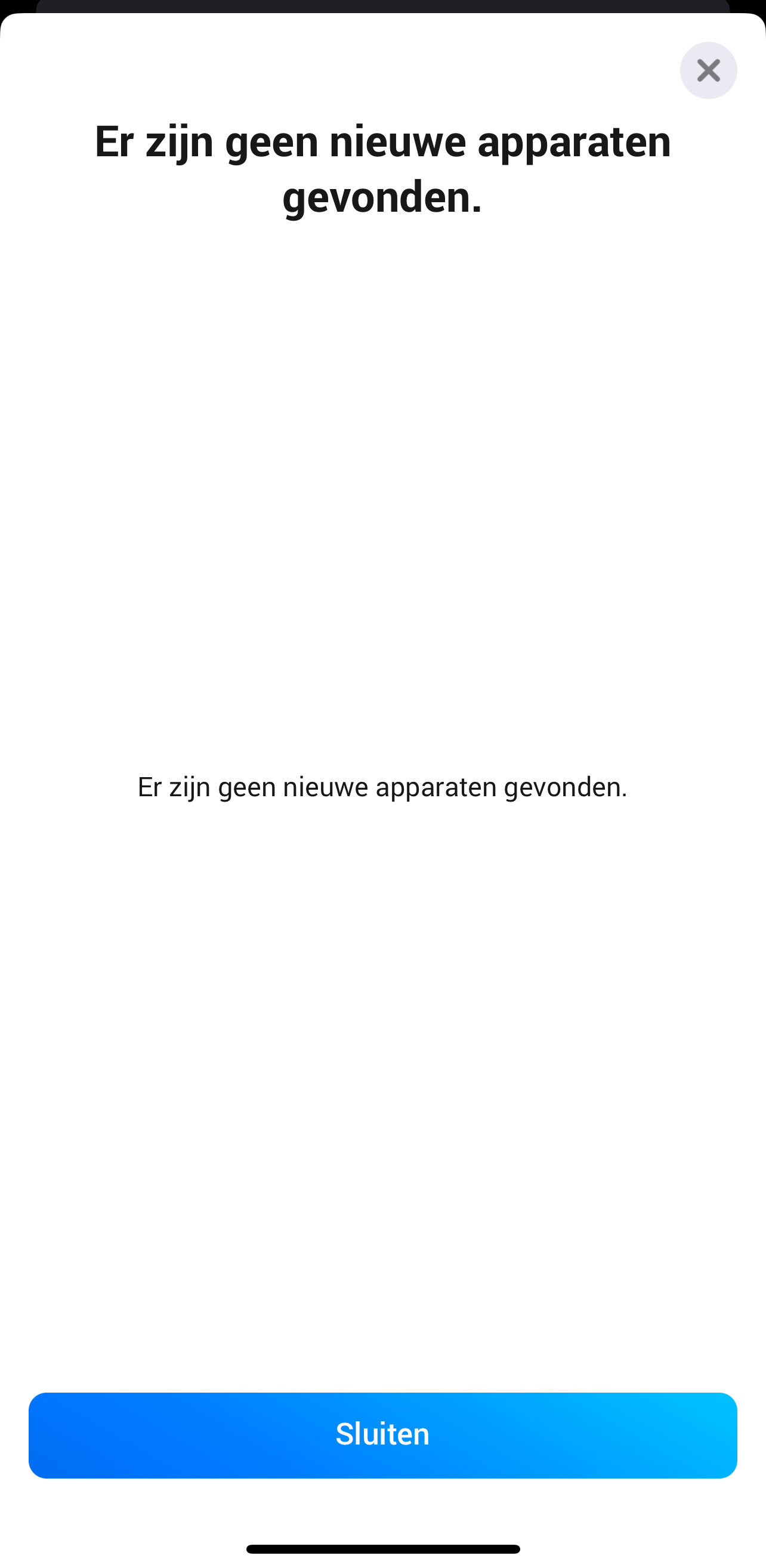

Hello Everyone,

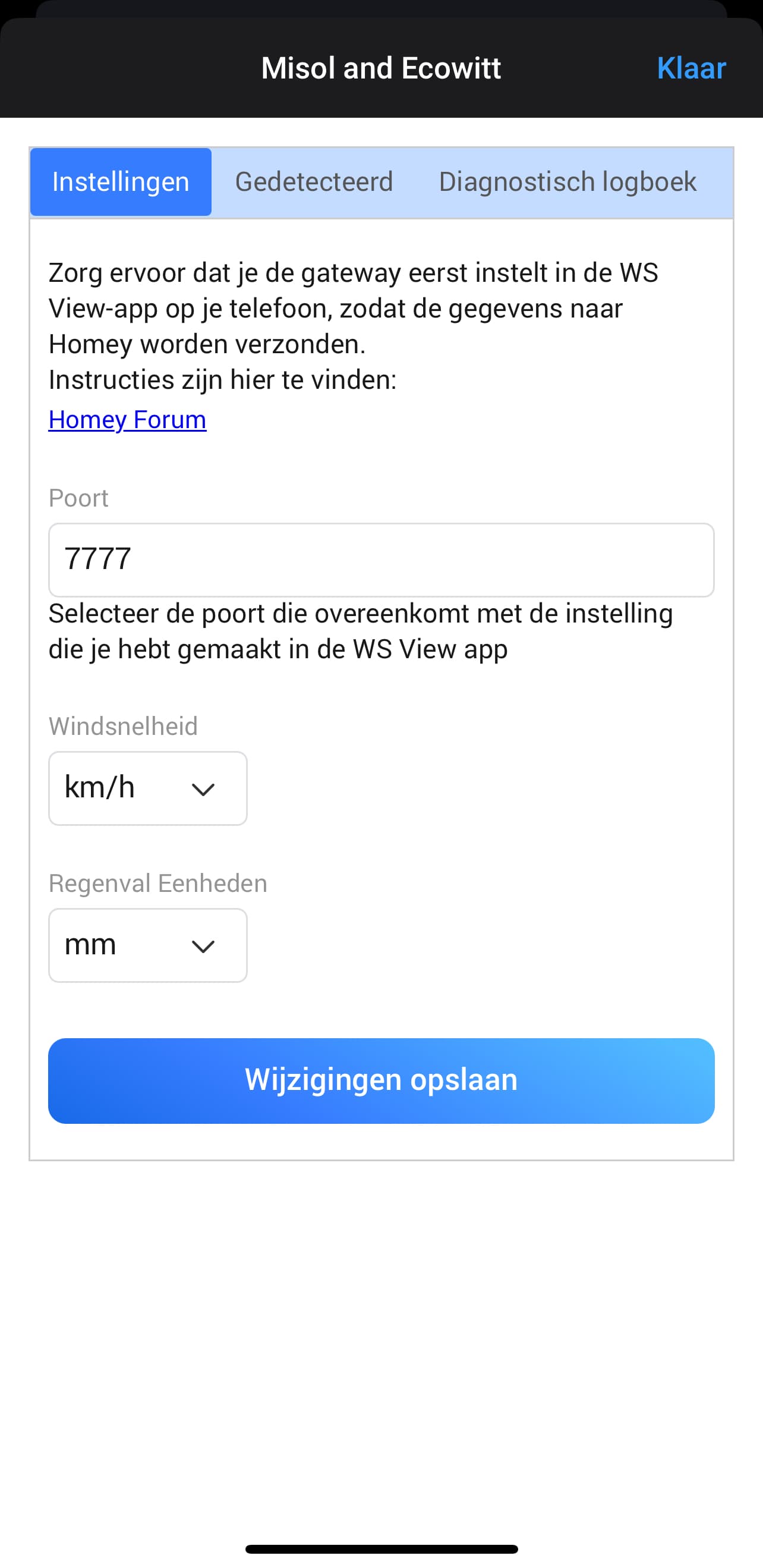

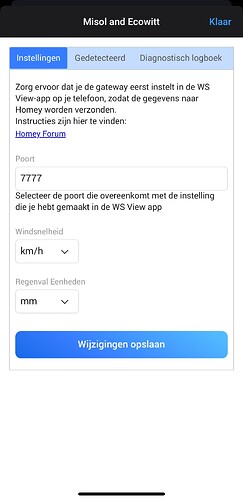

For quite some time now, I haven’t been able to connect my weather station to Homey. Sometime last year, it stopped receiving new data, and I couldn’t fix the issue.
Eventually, I decided to remove my weather station from Homey. The removal went fine, but adding it back has been a struggle. Homey keeps saying, “No new device found.”
I’ve checked all the settings, restarted everything, and made sure everything is updated, but I still can’t get it to work.
Unfortunately, my English is not great, so I used ChatGPT to translate this.
Thanks in advance—I’m stuck at this point.
Best regards,
Mark Stevens
It looks like the IP address you have entered in the first image for Server IP / Hostname is for the weather station gateway. That should be the IP address for Homey.
How incredibly stupid of me that I didn’t see that earlier
Thank you for your help.
