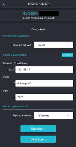

Nils
You should be able to add those with the Gateway and Weather station drivers.
Make sure you have configured the GW2000 to send data to Homey.
First you need to configure the Ecowitt or the WSView Plus app on your phone like this:
WSView Plus App
My Devices → tap on the DW2000 → More → Weather Services → Customized
Or…
Ecowitt App
Start Screen → ●●● → Others → DIY Upload Servers → Customized
Server-IP = IP address of your Homey
Configuration of the Homey Misol and Ecowitt app:
— Port: 7777
If you want to add the WS90 into Homey, please use the Weather Station device:
That’s it.
